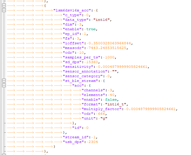

The measureodr in your config json file throws an error on reading saying it cannot be read as a string or an int.

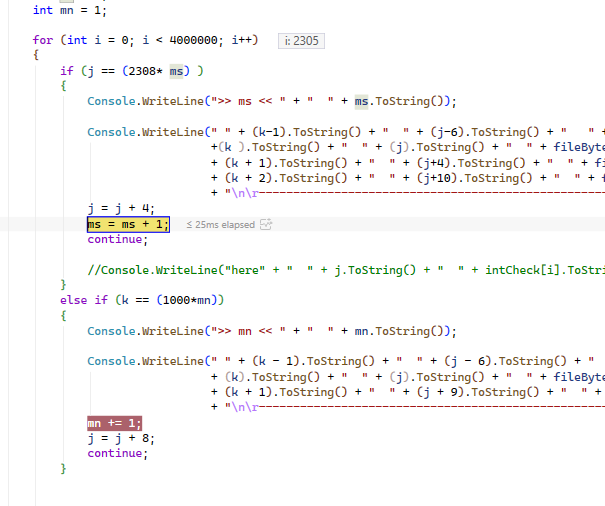

The picture shows the C# code to translate your dat file.  The two critical rates are the 2308 and the 1000.

The picture is the configuration file, it shows 2304.  And the program works with 2308 not 2304.

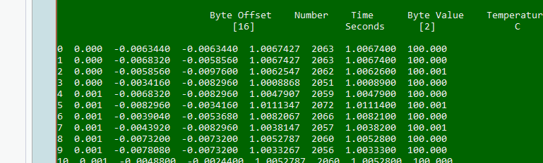

The mems studio outputs the CSV file, but the number of decimal places makes it hard to check your multiply factor.  The % error I cannot solve for as the input data is not accurate enough from the mems studio to calibrate properly, it is not important, but it was interesting for a while.  The last column is the % ratio between your mems studio and my estimate of the number.  It bounces around due to the rounding error in the mems studio output.
Is there as way to get more places from the mems studio.  You will notice that the first X and Y values are the same, statistically improbable, but the third X and the second Y are the same.  It is interesting and after looking at very many acceleration data files, I have not seen this before.  It might be me. I will check.

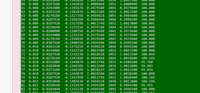

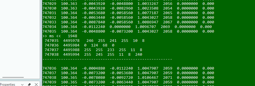

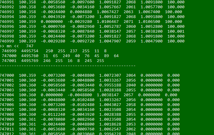

The MEMS studio gives me 741001 output lines of acceleration data.  Using the same files and my C# program, I go past the 741001.  Here I am showing you 6000 past , the 0.000 is the lack of data in the mems studio file.
I get 100.23 seconds and a cycle rate from the json files, do you know why the MEMS studio misses the data.  I cannot determine if it is accurate as I lack your data.  The MS 1948 is the number of 2308 cycles, the 4495984 is correct.  I had to hunt for the 2308, can you confirm the 747036 line is a four byte number, I cannot find a reference to it in the manual except to say it exists.

Here is the C# code.  It is not perfect, but now I can do FFT and produce pictures.

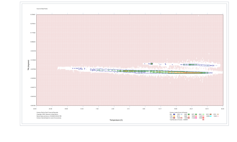

The interface will not let me load the picture of the tilt data on the bridge. It is enclosed.

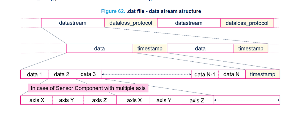

The picture is from your manual
It clearly says time stamp

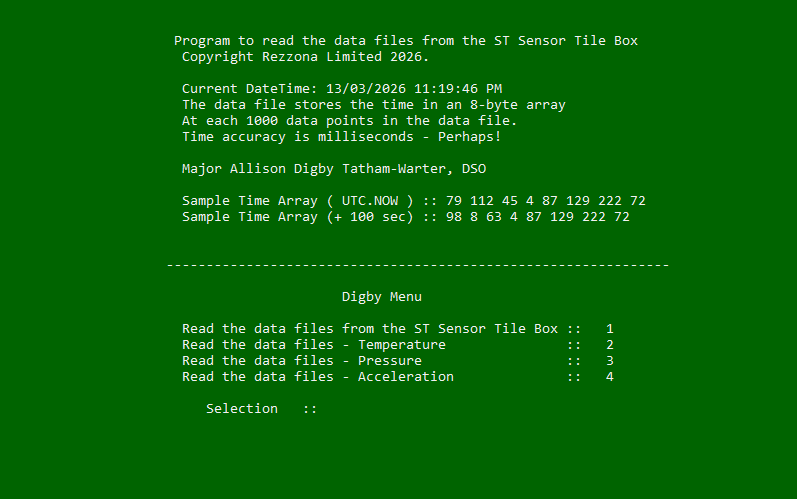

Your data file has time stamps every 1/7th of a second, give or take a moment,
This is my print of the first date at the 1000th location or byte offset 6012.

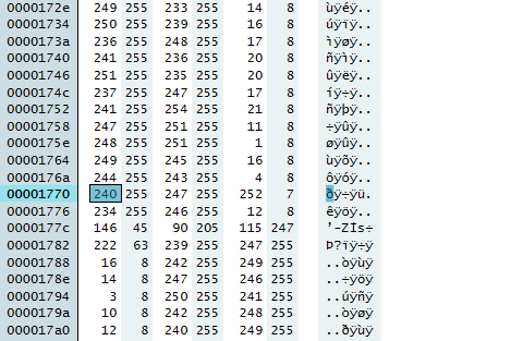

If I use a hex editor I can confirm the data.
So using the C# methods I got the byte code for the current date and time and added 100 seconds.  So the data that I recorded yesterday should have a 72 as the last byte, it has 63.

The analysis using MEMs studio does not align with my program.
You can see the 100 on the right hand side, this is the ratio of your number to my number. At Line 73 you have a duplicate number, almost impossible in reality, but you appear to have error corrected for something.
Any ideas how mems studio gives us spurious data.
