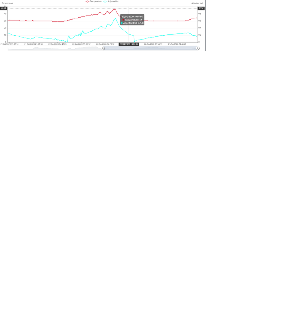

As I tested with, the LSM6DS drifted follow temperature. As you can image bellow, red line is temperature and green is degree (was calculated from X, Y, Z )
I'd like to confirm LSM6DS had internal temperature compensation? If NO, how to do it? Or any chip was integrated build-in this feature?

2020-04-24 3:45 AM
Hi Tuyen, the internal temperature sensor is calibrated at production tester level, while the ZRL and ZGL temperature variation gain is declared in the datasheet p.21. I suggest you to compensate via SW (real-time or in post-processing) the output data with the declared average temperature variation, positive for increasing temperature from 25°C, and negative for decreasing temperature.
