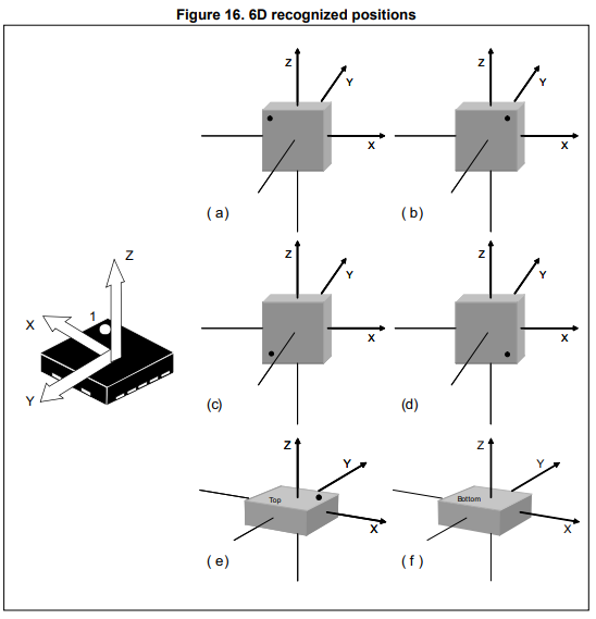

I have 2 LSM303C. Measurements show that the cooordinate system of the device is left-hand, but the "Figure 2. Pin connections" in the datasheet shows right-hand system (X-axis has an opposite direction). May be I do somethig wrong?

Hi @ILuzi.1​ , please consider the picture at p.40 of the LSM303AGR AN4825 app note: this should be correct. Not sure however why the X axis on the other picture is in the opposite sense... I'll check internally and let you know.

Hi Mr. Eleon Borlini. Thank you so much for your quick reply. My measurements show the orientation of the axes exactly as in the illustration on page 40.
