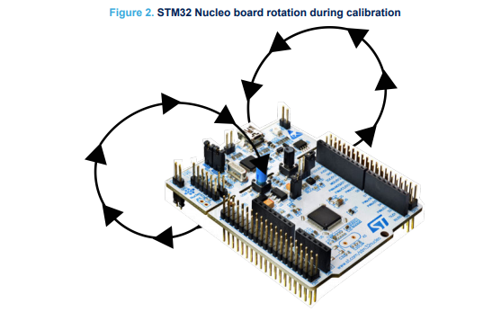

Hi @marten , it is usually suggested to perform a calibration of the magnetometer before launching the MotionFX library, and you basically can do the magnetometer calibration in two ways:
Regards
2020-06-05 6:28 AM
thx for the fast reply. I already calibrated the magnetometer using the push button function of the sample code. Calibration was successful.

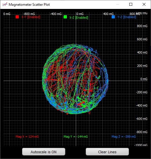

2020-06-12 1:19 PM
2020-06-12 1:22 PM
please see the scatter plot after calibration. I also attached the data log of Unicleo GUI. The board is static at the table. The heading values are constant (but incorrect) while the heading error increases. What does the "heading error" value represent and why is it increasing.
Thx,
Marten
