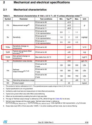

You haven't said what accelerometer you are using.
How to write your question to maximize your chances to find a solution
There should be temperature data in the datasheet?
I am using the LIS331 sensor and have attached the datasheet here.
So did you read the datasheet to find the temperature-related specification ?
It is your job as designer to study the datasheet ...
Yes, I have studied it, but I am looking for an appropriate algorithm to compensate for temperature when using bias and scale coefficients.
Your attached datasheet doesn't seem to work.
Here's the ST Product Page: https://www.st.com/en/mems-and-sensors/lis331dlh.html
The temperature variations are specified in Table 3 of the datasheet:
https://www.st.com/resource/en/datasheet/lis331dlh.pdf#page=9
