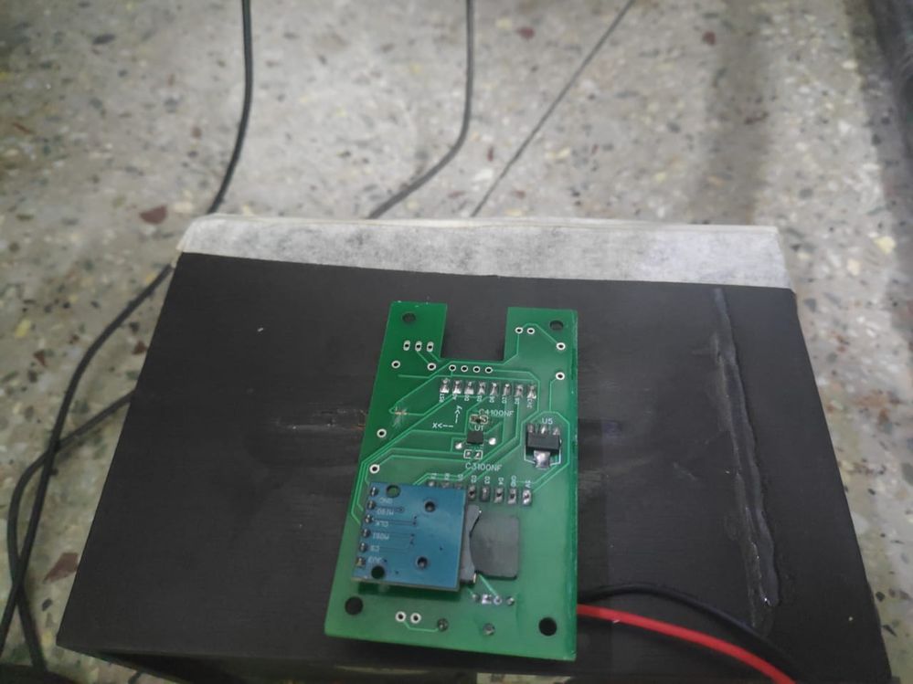

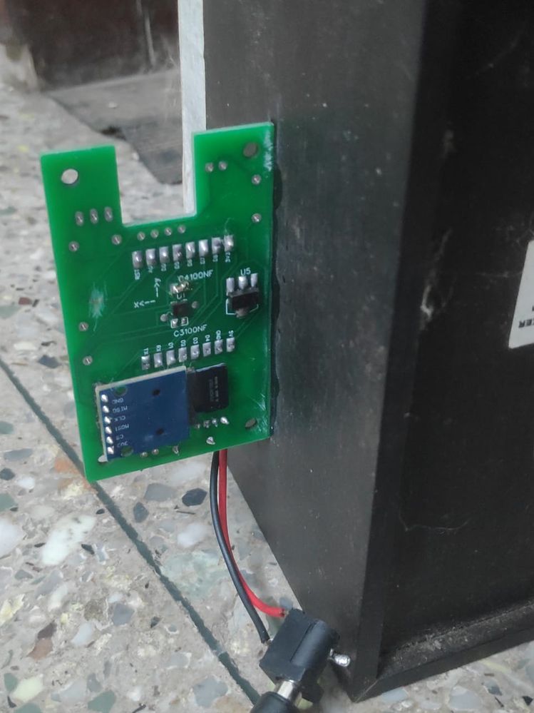

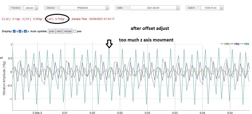

I have got 2 new IIS3Dwb IC from same lot , I made custom PCB for those, connected to shaker and getting acceleration values and showing it through my own developed application.

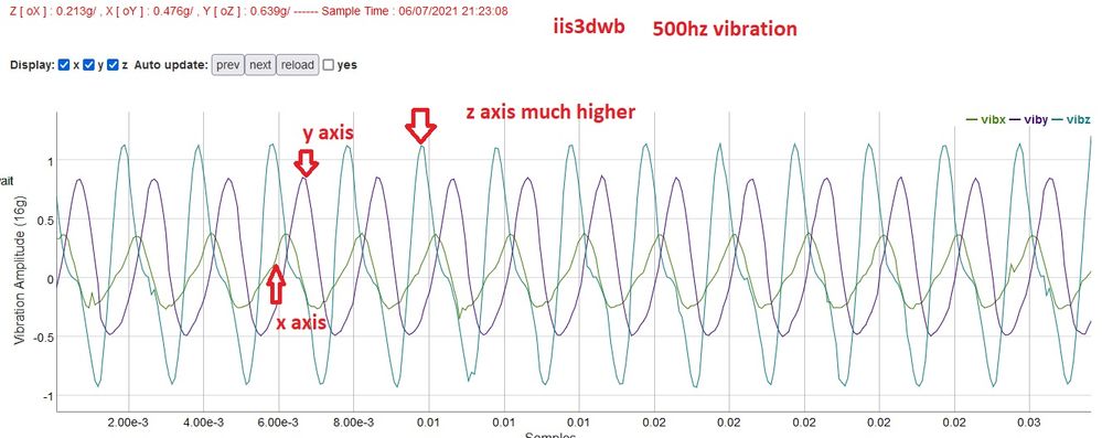

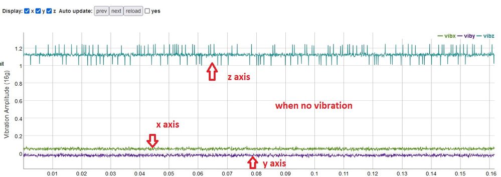

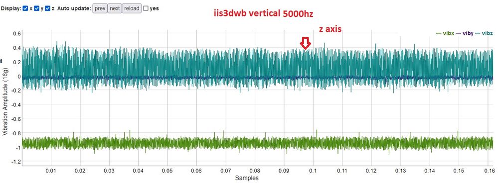

Problem: Z axis seems defecting /sensitive much higher than x and y axis irrespective of vibration direction orientation.
When no vibration present every axis values seems ok and showing 1g level of gravity.
Both ic s showing same issue
Tried magnet, glue mount but no improvement.
Tried different vibration source , different vibration frequency
Changing pcb orientation didn’t help.
Not using int pins, mcu controlling sampling speed 12.5 khz sampling speed and 6.3khz bandwidth with 16g sensitivity.
Using single axis mode, fifo disabled

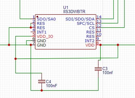

Pcb layout below.
When no vibration getting 1g so I believe my g conversion math is ok.

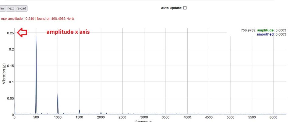

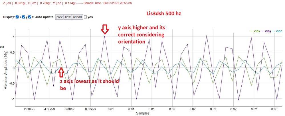

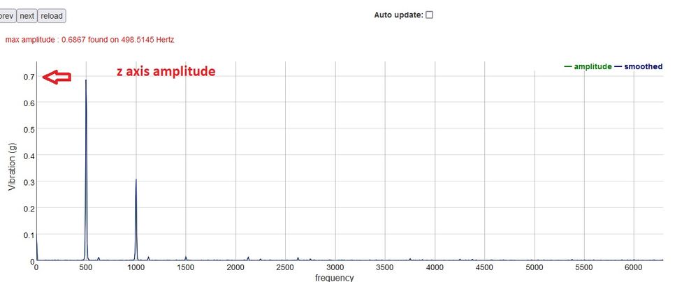

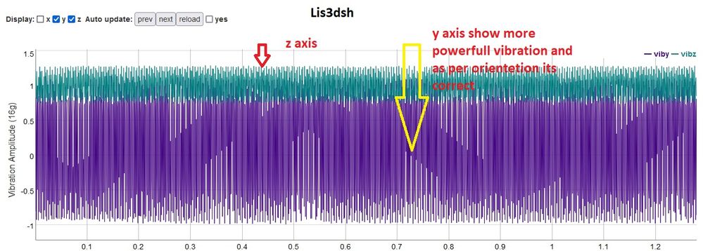

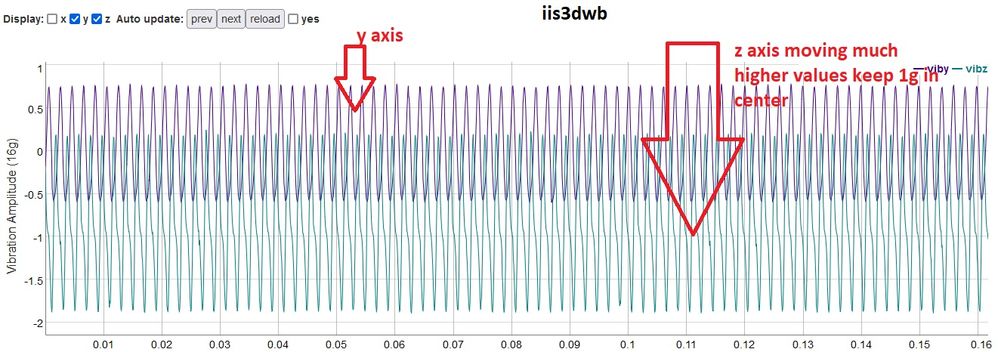

I compared IIS3dwb output with LIS3DSH output placing same place same orientation , when shaking at 500 hz lis3dsh showing y axis is having high g and its correct as shaker is shaking in Y axis. However IIS3dwb showing Z axis is sensing higher g values than y axis. Which is surely not true. To crosscheck I changed axis orientation against vibration orientation, but still z axis is sensing high g
In fft view also all axis showing correct frequency but z axis is showing much higher amplitude
Now I am clueless what is wrong, is both IC faulty? or something wrong in settings
Thanks for reading any help appreciated.

@Eleon BORLINI Thanks a lot for your reply , I have tested as per you suggestion .your question answer below
Did you try to configure the 3 axis mode (enabling the bits in CTRL6_C (15h) named XL_AXIS_SEL[1:0] = xxb (11 = Z-axis);
= yes only noise increased but z axis still deflecting high
Did you try to configure the BDU bit in CTRL3_C (12h) register? With this bit the output registers are not updated until MSB and LSB have been read)
= yes but nothing changed
You wrote: >> Not using int pins, mcu controlling sampling speed 12.5 khz sampling speed and 6.3khz bandwidth: this means that the sampling frequency is less than double of the device bandwidth, so I'm concerned whether the signal can be properly reconstructed and, if there is some issue, aliases effects can rise --> could you try to increase the sampling speed from MCU side (even if you are shaking at 500kHz)? Note also that IIS3DWB ODR is fixed to 26.667kHz.
= datasheet mentioned that "Ultra-wide and flat frequency response range: from dc to 6 kHz (±3 dB point)" so I kept bandwidth on that limit.
I tried high sampling speed 26 Khz ( bandwidth of 13khz ) but results is same high z vibration, I am shaking at 500hz not 500khz btw
There could be also the possibility that the spikes you see are true: in the LIS3DSH case the maximum ODR speed is 1600 Hz, while in the IIS3DWB case you have a fixed, high rate of 26.667kHz, so it's possible that the spurious spikes are above 1600Hz, but can be detected by ODR speed of 26.667kHz.
= if you check fft images vibration is at 500 hz which is in range of both lis3dh and iis3dwb and there is no powerful spike after 1000 hz as captured by iis3dwb . if we just compare iis3dwb x axis and z axis z is much powerful than x at 500hz itself so we can ignore higher frequency spikes right?
please note i have checked changing orientation of axes if source z axis really having high vibration then after rotating iis3dwb 90 degree , x or y axis vibration should be increased right? but z axis always showing high sensitivity in what ever angle I connect to vibration source.
The Z axis might have a higher offset than the X and Y ones: you can try with compensating the offset configuring the OFF_Z (12h) register.
= I think offset is not issue here while z in parallel with earth (1g) while no vibration its showing 1g. if we apply vibration z axis defecting (up down) keep 1g range in middle. please check time vs g graph image. similarly after rotating 90 degree or any other degree offset also get changed but still Z axis showing high movement.
You can try configuring lower than 16g Full Scale, such as 4g and 8g, and check the behaviour.
= yes I tried 2g mode 4g mode but that did not solved the issue.
here comparison image of lis3dsh vs iis3dwb at same vibration source same orientation same location
waiting for you further help

I was also thinking the specific lot of IC having some fault. or may be while soldering manually high heat might damaged both IC ? though everything working fine except that z axis sensitivity and after seeing first IC issue I minimum heat possible on second IC

>> or may be while soldering manually high heat might damaged both IC?
It is a possibility, especially in case the heating is directional along a specific axis of the device, the Z axis in your case.

2> I know how to convert LSB to Acceleration ( g ) and please check top image z axis values are near 1g when stable.
now back to the main issue
I re ordered 2 new ICs from mouser electronics replaced old IC
after testing got same problematic result ( X axis , Y axis ok but z axis vibration amplitude is much higher than actual

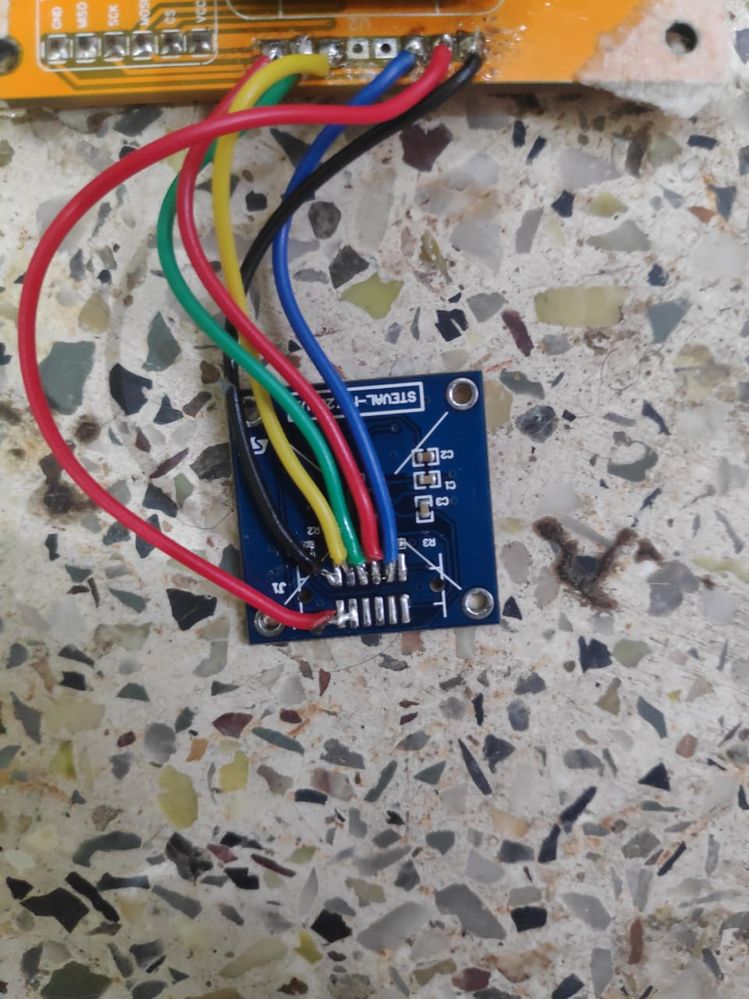

I also ordered STEVAL-MKI208V1K as per you suggestion connected with my processor but got same problem
so as the IC is already soldered we can eliminate IC damaged during hot Air soldering
so let me summarize
1> its not calculation error ( lsb to g ) as 1g can be seen when no vibration
2> its not offset error ,connect to vibration source in any direction but z axis movement always high
3> hardware (IC) is ok
