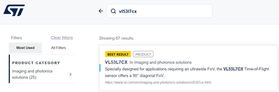

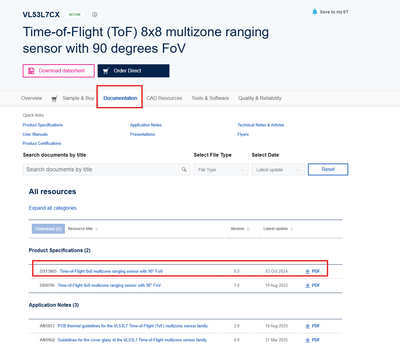

About the VL53L7CX documentation files. you can log in www.st.com and search vl53l7cx. Then you can get the product information. Click to enter and you will find all the documentation. Chapter 4 of the datasheet provides detailed instructions on the I2C communication interface, which can be used as a reference.

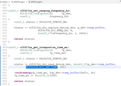

I see your points. you can download the driver package and there are many API interfaces available for reference in vl53l7cx.api.c. From these interfaces, you can roughly understand the meaning of register and the value how to set. I think these should be enough for using and developing a project.
Additionally, I would like to clarify that for all register information are confidential. Really sorry for that. However, if it is a real project, welcome to contact our FAE and get what you want to know. Thank you.
