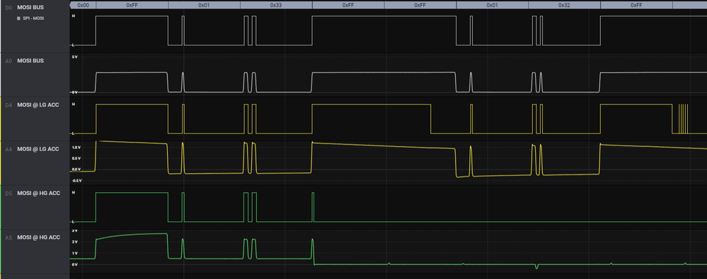

That's a bit strange, since the SPI and the I2C protocols are very different. Do you have a screen of a scope with the I2C output of the device lines while communicating SPI with the flash memory?
This request in order to understand what the device are getting in output and whether this is cross talk noise or valid data.

Yes, the H3LIS100DL, IIS2DLP and flash all share the same SPI line except for CS. We currently run SPI at a 500kHz frequency since we are running our MCU at 1MHz, however we did boost the MCU up to 2MHz and we tried SPI at 1MHz to see if that resolved the issue. It did not.
Below is a plot that demonstrates the issue – note that there is a 10k series resistor between the shared bus and each of the accelerometers (allowing us to see what is happening at the device vs. on the bus). MOSI@LG ACC is the MOSI line at the IIS2DLP and MOSI@HG ACC is the MOSI line at the H3LIS100DL. You can see that, after 0x33 is written on the shared bus, the H3LIS100DL tries to pull the bus low – however the 10k resistor is large enough that the shared bus is not affected.
Note that, in SPI mode, this additional series resistance does not impact communications with either accelerometer. So, additional series resistance may be an inexpensive solution to the problem – however the preference is to prevent the accelerometers from even listening to the MOSI line when CS is high. We’ve implemented a tri-state buffer in the meantime, which works well, but does have a parasitic current penalty.
