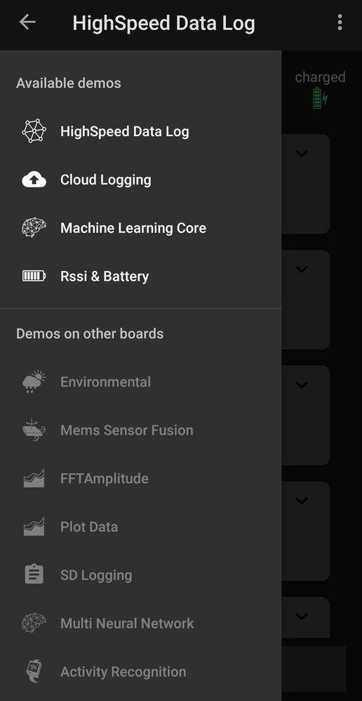

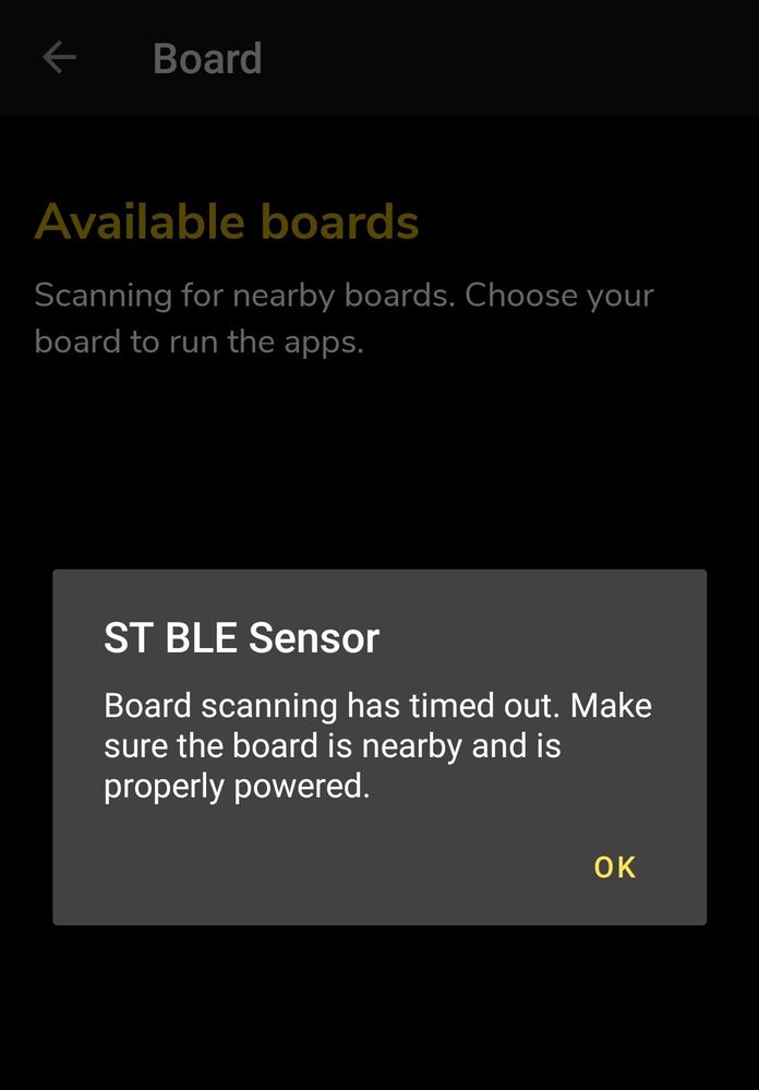

in ST BLE, New application>Vibration monitor> Training>>Play result in Boards scanning running out.

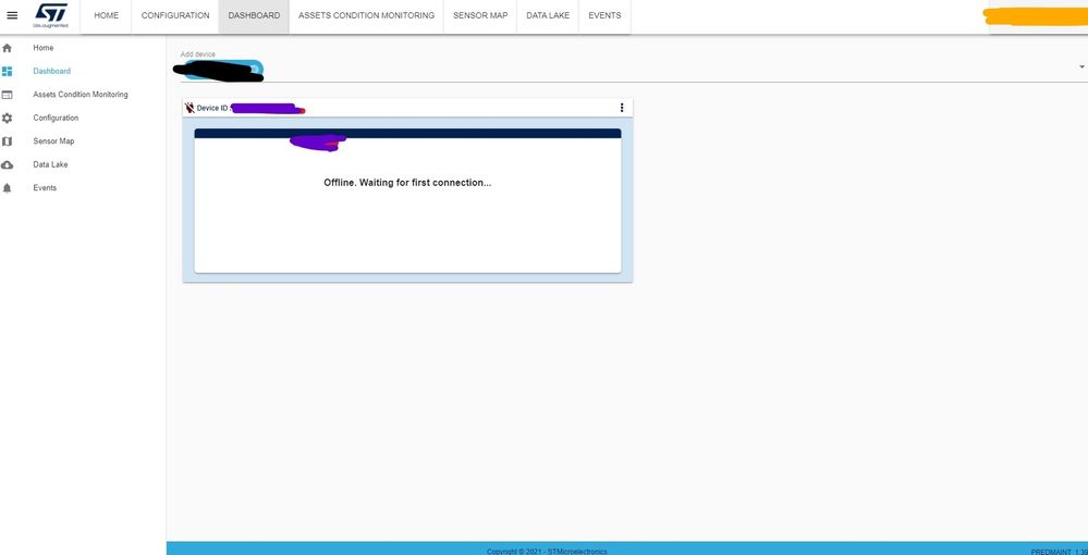

I've added the AWS security key and private key in Cloud menu of the BLE app. it notifies AWS Active still in the dashboard it says device unconnected.

However, I am not able to succeed with the Dashboard of predictive maintenance with STWINKIT1B(No wifi only Bluetooth). I do add the AWS link and key and it returns

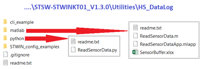

Ps: the files .dat are raw file (like a binary file) so for see its contents is necessary elaborate it’s, also taking into account the .JSON file which internally has the acquisition sampling rate. Inside the Utilities folder, a MATLAB and a Python script are available to automatically read and plot the data saved by the application.

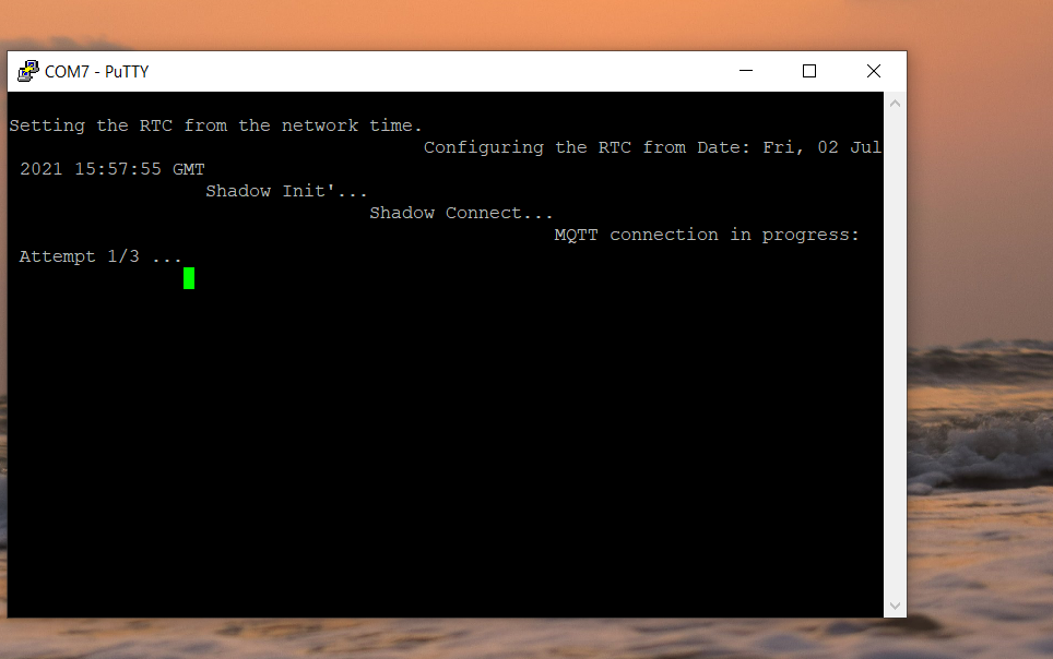

I've got the wifi expansion module but it stucks at attempt after all the keys enter
2021-07-02 9:06 PM
I get this error:
Configuring the RTC from Date: Sat, 03 Jul 2021 04:03:28 GMT
ERROR: aws_connect_to_cloud L#97 The length of the device name stored in the iot user configuration is larger than the AWS client MAX_SIZE_OF_THING_NAME.
AWS IoT SDK Version 3.0.1-
Shadow Register Delta ErrorCLOUD_WIFI_CONNECTION_ERROR
*** Cloud connectivity demonstration ***
