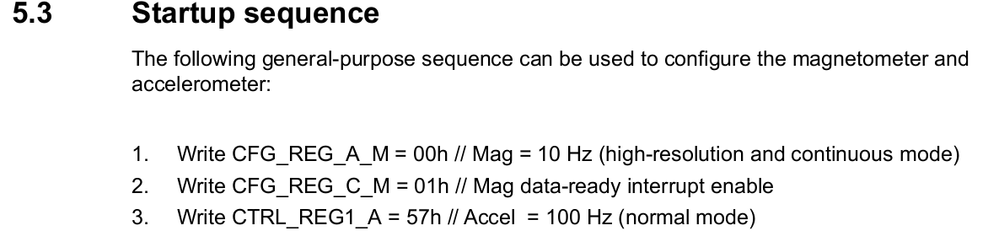

Actually I need to read acceleration and magnetic components using G071RB and LSM303AGR with STM32CubeIDE.

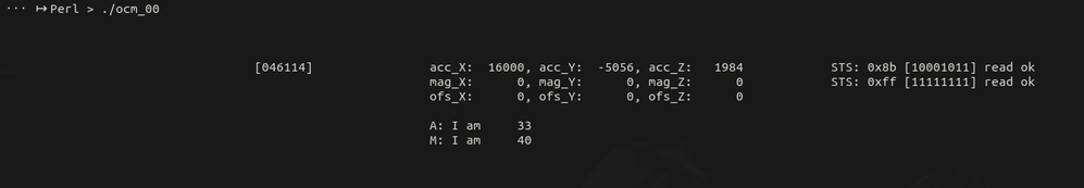

I tried to understand anything reading the Datasheet, but it is really hard (well, I am not familiar with such devices. I rather deal with different things usually). I managed to get proper who am I values, and reading the Acceleration components and their status register give some values (they change in time). The velues of magnetometer are constantly 0 and their status is constantly 0xFF, although the reading procedures git HAL_OK as output:
I did initialize the registers as it was suggested in Datasheet:
