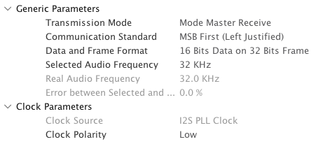

Through Mx, the I2S peripheral is configured as follows:

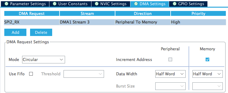

Then, the DMA is configured as a circular buffer, half-word:

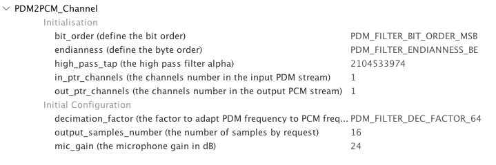

Finally, I have configured the PDM2PCM library as follows:
Starting from that configuration I'm having trouble understanding why the PDM2PCM is not working as expected.

Now I have 16kHz selected audio frequency, 16-bit data on 16 data frame, 64 decimation. Therefore the I2S clock should be 1.024MHz.
I record the audio of a pure tone (e.g. 500Hz) and then I convert it to a 16bit, 16kHz .wav file. The problem is that the recorded audio, played has double the frequency of the pure tone (1000Hz in this case). How could it be possible?
Changing the data and dataframe format to 24-bit in 32 data frame solves this issue.
But I don't undestand why!
Why with 16-bit data the pure tone appears with a double frequency?
