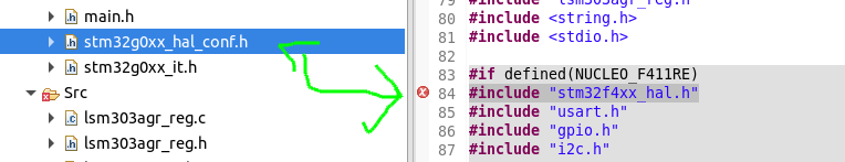

2021-11-15 12:33 PM
2021-11-15 11:34 PM
Unfortunately, your picture was not inserted correctly so that nothing can be seen here.
Well, my hints weren't a recipe that you just have to paste, but hints as to which code blocks you have to make changes in.
The #define and #if defined are used to make hardware-specific settings in the source code. So you should have a look at stm32f4xx_hal.h from the repository (locally on your computer if STM32F4 firmware is installed, alternatively on Github), plus the schematics and description of the NUCLEO-F411RE.
Finally compare the NUCLEO-F411RE with your NUCLEO-G071RB (schematics, description) and make the appropriate changes to the copied blocks.

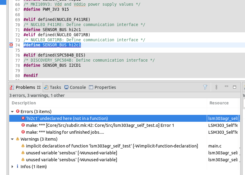

#endifIt turned out that without commenting out the lines 14-16 above I got messages that the h-files do not exist.
This however did not help, for after that I get the error:

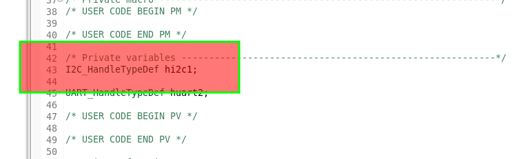

Well, the variable hi2c1 is defined here:
in main but but it is not seen in the very example function .
I do enclose the ZIP with the whole src directory. please make necessary corrections and share.

2021-11-23 8:24 AM
Sorry, I didn't see a question other than a request to correct the code. However, rarely someone will change the given code here, but will give hints on how to do it yourself.
However: if the compiler cannot find the .h files, they are not included in the project. In your case, this is due to the fact that you probably created the frame program with STM32CubeIDE, whereby the default setting in the Project Manager ensures that the code for all peripherals is put together in one main.c/.h. If you check Generate peripheral initialization as a pair... in Project Manager > Code Generator, you will get the .c/.h files you are looking for, e.g. gpio.c/.h, i2c.c/.h, etc. But every programmer does this the way he likes it and in your case it is not absolutely necessary to change this setting, just leave the missing .h files commented out.
But it would be helpful to read the introductions that you can find at the very bottom of the main Github site and at the device driver site, in your case the driver site of the LSM303AGR. The main site also contains an example .ioc file for the NucleoF411, see here, which can be used as a template.
