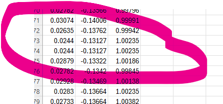

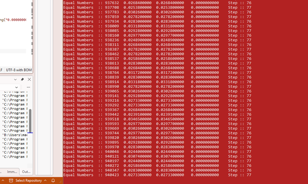

It is fully duplicate data, so now I need to check your log file for errors.  Thanks.
The duplicates are at 0.01 second intervals except when they are not.  When they are not they are at 149 and 2.
I like the two numbers 2 and 149 because they are both prime and 76 and 77 are not.

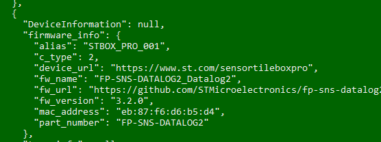

Dear Simone:
I am running the firmware that pops up after you install the 1.0.0., I think it is called 1.3.0 or some such.

The screenshot you shared shows fw_version 3.2.0. It is the latest, most updated one.

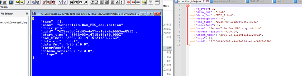

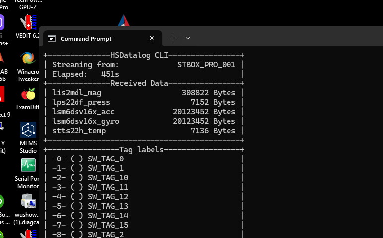

This is from the end of the day running your CLI Example that is compiled already. Note the bytes.

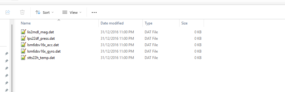

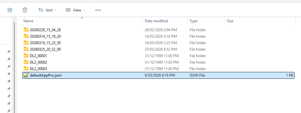

I pressed esc and got
Notice the zero file size, it is always recommended that you flush files as you write to the file.
___________________________________________________________________________________
183
Consider writing to a file. This is an expensive operation. If in your code you write one byte at a time, then each write of a byte is going to be very costly. So a common way to improve performance is to store the data that you are writing in a temporary buffer. Only when there is a lot of data is the buffer written to the file. By postponing the writes, and writing a large block in one go, performance is improved.
Performance as suggested by this author is not improved if nothing comes out.

The DLetc files come with an interesting start date, The older files do not.

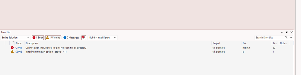

This is the SLNX file. The cmake does not create a solution that finds all of the log.h and 377 other errors once I fix that error.  I have traced all of your paths etc, but having an error that INT is undefined, is challenging.
I appreciate all of the work that has gone into this, but have you created a Windows 11 Visual Studio Solution, if so can I have it?
