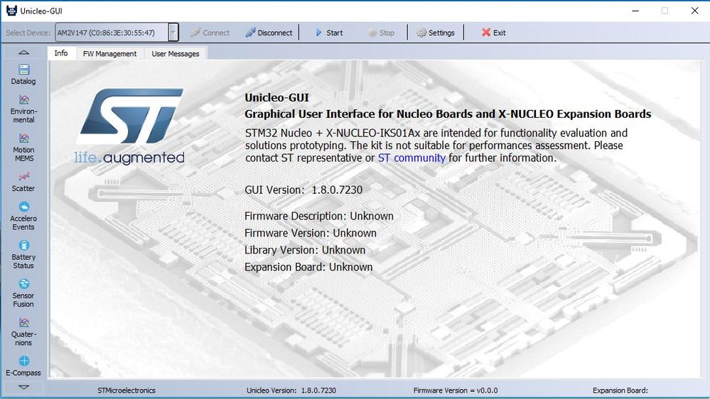

I'm facing with a issue on unicleo gui and sensorTile sensor (with ALLMEMS1 and ALLMEMS2 librairies).
I dont know why, but since few day i can pair and connect my sensor tile with bluetooth on my laptop (W10) but unicleo doesn't show the normal interface with sensor picture and librairies selection.
i try to update my bluetooth driver, update gui to 1.8, uninstal/install all driver and soft but same pb!
Is anybody encountered the same pb, and have a workaround?
For finish, sensorTile work fine with Android STBLE app!
thanks
2019-06-06 11:57 PM
unfortunately the ALLMEMS2 FW is not yet supported.
Could you please try again ALLMEMS1 and if it doesn't work send us a screenshot.

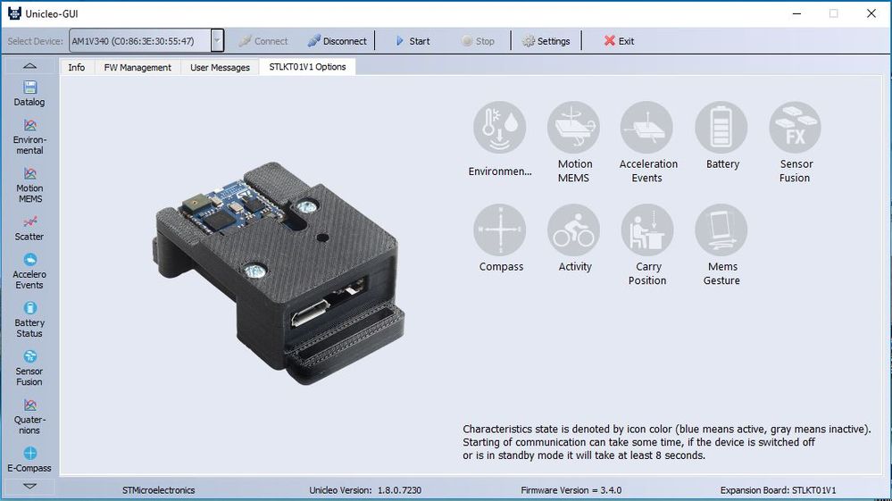

I double checked it now with Unicleo-GUI 1.8.0 and ALLMEMS1 3.4.0 and it works fine for me.
2019-06-07 1:13 AM
Many thanks for your answer!
So I try with the same setting ALLMEMSV340 and unicleo 1.8, and it work fine!
Do you know if ALLMEMSV2 will soon be supported or not?
Thanks
2019-06-07 2:29 AM
We will try to add it in the next release in a few weeks.
