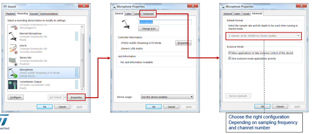

Hi, if you are using win7, the device is recognized as a standard, xx channels microphone. If you did't already do it, you should check the mic configuration, right clicking on the loudspeaker icon on the bottom right of the windows screen and choose “Recording devices�? in the following way. Regards

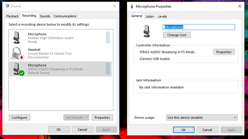

hello
thanks for your reply.
I am using Win 10,
that is what I see when the configuration is 2 channels, 48000 sample rate.
the Advanced Tab not exist.

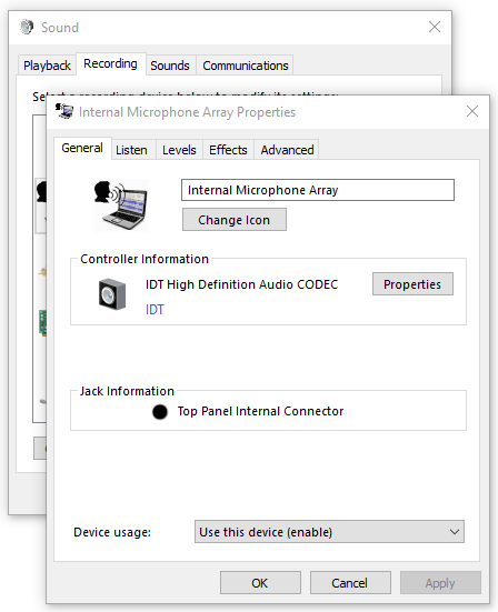

Hi @JHuang ,
that's strange... I can see the configuration with Win10... may it be a matter of administration permissions?

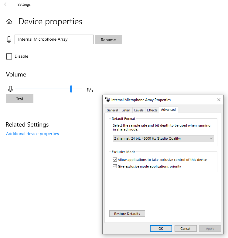

You may try this other way. Go to Sound settings --> Input --> chose the correct input microphone --> Device properties --> Additional device properties --> Advanced
-Eleon
