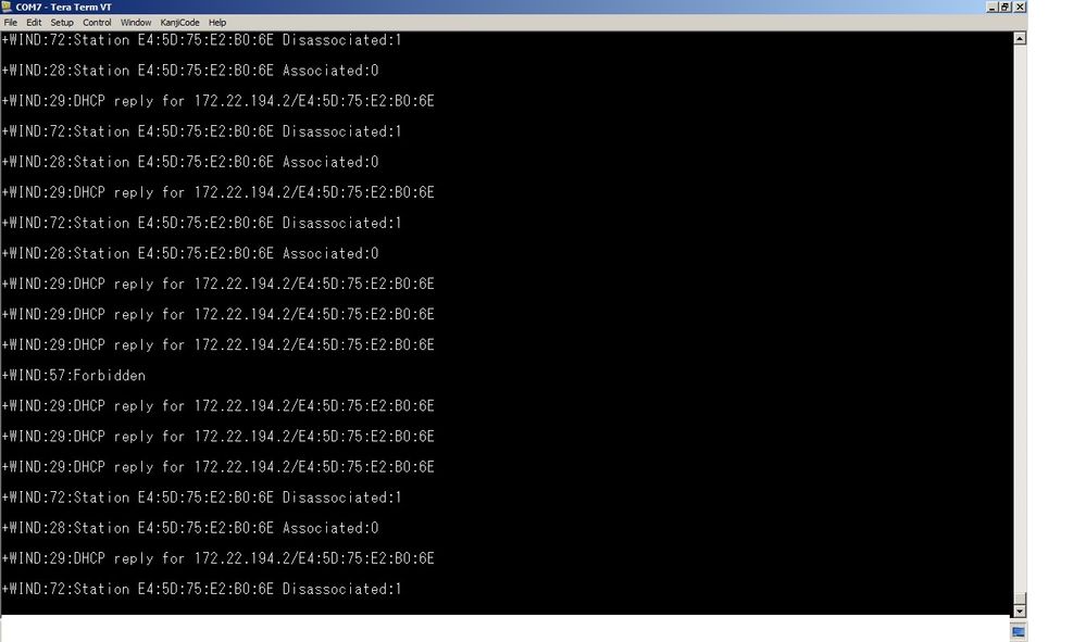

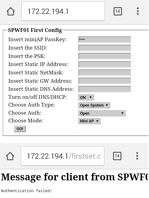

Hi Gerardo,
Thanks for the reply. I tried to set the SPWF01SA in miniAP modeby using the following command
AT+S.SCFG=wifi_mode,3
AT+S.SCFG=wifi_priv_mode,0
at+s.ssidtxt=
EM
at&w
at+cfun=1
And after this i connected it to my PC and entered
in the address bar and tried to setup the miniAP mode as per the datasheet and following error pops up.And in the COM Port i am receiving the Forbidden error message.
Can you tell what is going wrong here.

2017-04-11 11:53 AM
When in miniAP, and 'ip_apredirect' configuration variable is not empty, default homepage is changed.
Now, if you want to really perform the remote configuration of the module via HTTP, this is the right page!
Why are you getting that message? Because password is wrong
Fill 'PassKey' field with content of 'user_desc' configuration variable. Default is 'anonymous'.
Let me know...
jerry

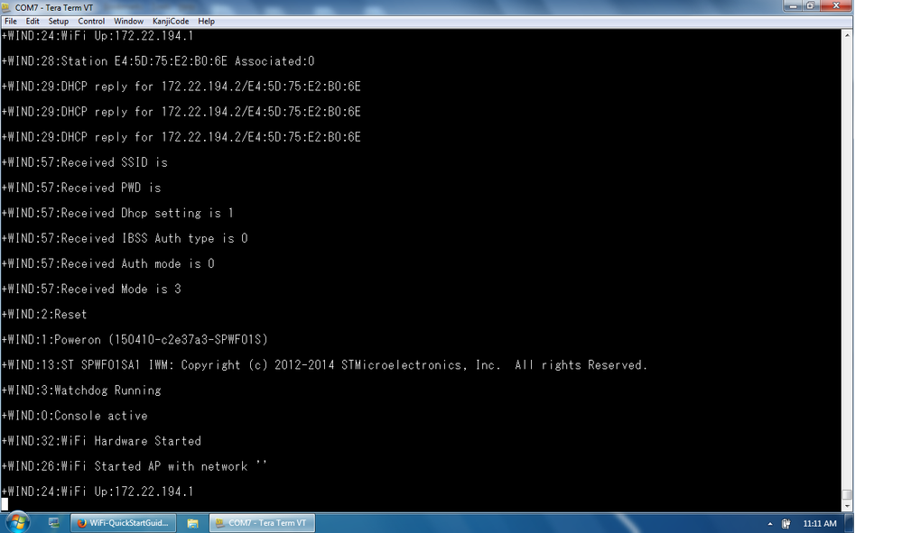

Hi Gerrard,
I tried to set up the module in MiniAP mode by using the password 'anonymous' in the captiveportal.net as mentioned in my previous post.Below is the response i am receiving from the module.its getting reset and after that its not showing up in the WiFi Scan List
What will be going wrong here?
Best Wishes
Don
2017-04-12 9:53 AM
You sent an empty SSID string.
WIND:57 (before reset) and WIND:26 (after reset) are clear.
Follow the handson STSW-IDW002
