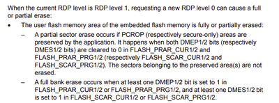

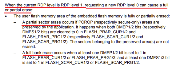

3- The RDP regression from level 1 to level 0 the mass erase is automatically performed by hardware. This is the condition described in the reference manual RM0399:

As stated in my previous post, that question has been answered in this section in the reference manual:
If you need an explanation of that section you need to open a new post because that's a new question and close this one.
