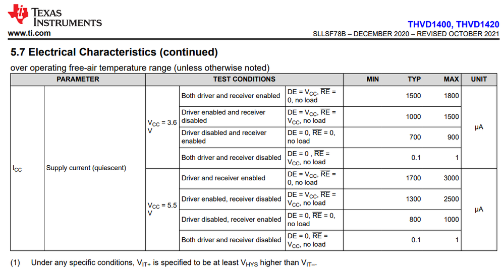

Are you correctly disabling both receiver & transmitter to achieve minimum consumption:

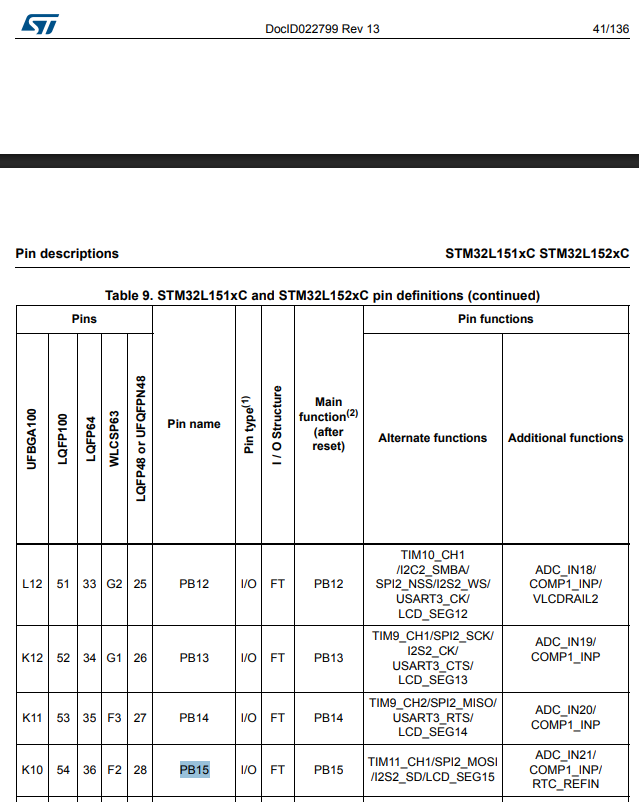

The transciever is in low power mode, I made many current measurements to know for sure it is doing it. I ended up changing the pin to PA12 for controlling the DE pin and the problem was solved, so it has to be something related to the pin PB15 capabilities as all I did was just changing the pin on cube MX.

@VLe R.1 wrote:I ended up changing the pin to PA12 for controlling the DE pin and the problem was solved, so it has to be something related to the pin PB15 capabilities .
Indeed, there's a lot more stuff on PB15 than on PA12:
