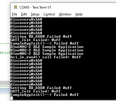

2022-12-21 11:41 PM
hi, @Roberto Giovinetti did you resolved the issue ? if yes then can you please help me out with bnrg2a1. here below is are the errors im attaching.

2022-12-22 3:34 AM
ok thanks for your time.
