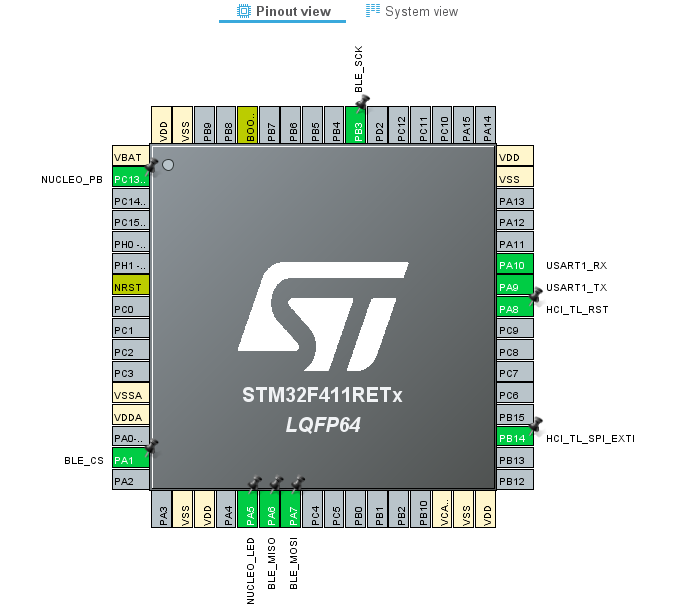

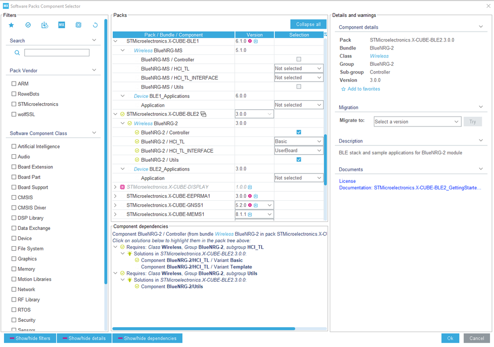

I picked up a X-NUCLEO-BNRG2A1 (Extension board Lot:2040 for the Nucleo-64 boards), and I am trying to communicate with it through a Nucleo-F411RE Board. I basically generated a project template through CubeMX for the STM32F411RE and included the BlueNRG-2 (X-CUBE-BLE2) Pack to include Bluetooth HCL/ACI APIs along with the project template.
I also assigned in CubeMX (in the Software Packs section) that I will be using SPI1 bus, GPIOB Pin 14 for the SPI EXTI Pin, GPIOA Pin 1 for the SPI1 CS pin, and GPIOA Pin 8 for the HCI_TL_RST Reset Pin.
I also configured the SPI1 bus to be Full Duplex Master, Prescaler = 128 (to obtain 781.25KBit/s baud rate), CPOL Low, and CPHA = 2 Edge (based on the configurations found in an example project under X-CUBE-BLE2\3.2.0\Projects\NUCLEO-L476RG\Applications\SampleApp).

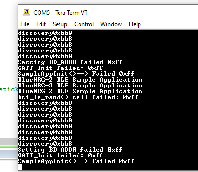

My project never seems to successfully execute Startup_DeviceAddress() as it seems to not be able to communicate with the BlueNRG-2 module through SPI during these two instances:
/* get a random number from BlueNRG */
ret = hci_le_rand(random_number);
ret = aci_hal_write_config_data(CONFIG_DATA_PUBADDR_OFFSET, CONFIG_DATA_PUBADDR_LEN, bdaddr);I scoped the SPI1 bus that should have exchanged data with the BlueNRG-2 and observed that only the CS lines were pulled low and then high immediately, without the STM32F411RE Nucleo toggling the SPI_SCK or SPI_MOSI (no data was sent through the SPI1 bus and the STM32F411RE immediately disabled the SPI1 communication).

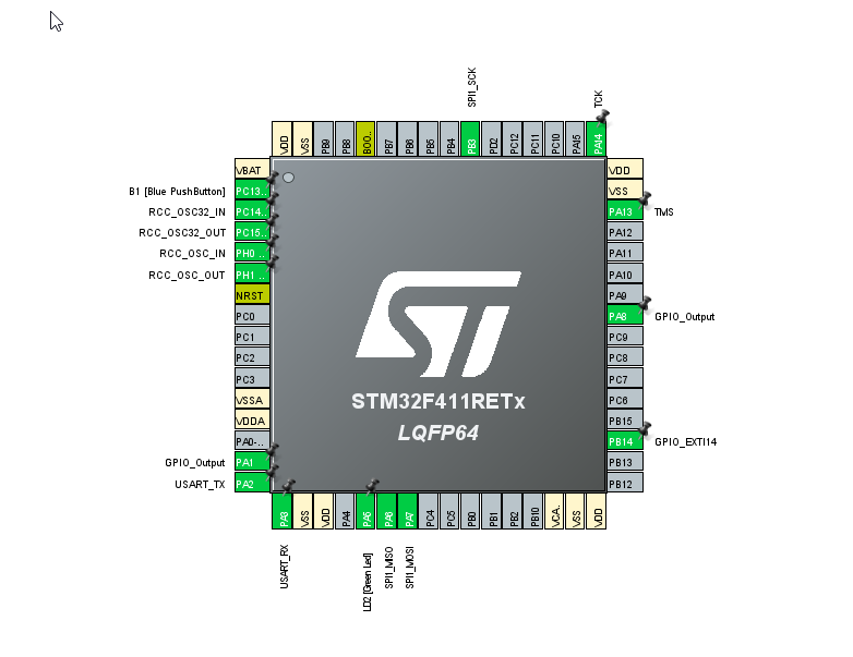

concerning the pinout configuration, if you want to use the PB14 as SPI_IRQ, you should also bridge the PIN 28 of the CN10 on the Nucleo board with the PIN 28 of the CN10 on the X-NUCLEO-BNRG2A1. Otherwise, you can use PA0 and you don't need any bridge.
In any case (either using PA0 or PB14 with the bridge), please, do not forget to enable the corresponding interrupt line from the NVIC view in STM32CubeMX.
The following picture shows the complete pinout configuration (please, note that the USART2 is used).
Anyway, you can find all the information on how to setup a project for your X-NUCLEO-BNRG2A1 in the Getting Started Guide included in the X-CUBE-BLE2 package.

Thanks for the response! Regarding your CubeMX pinout configuration, when including the X-CUBE-BLE2 package, CubeMX did not ask me to link any USART pins or RCC_OSC32_IN, RCC_OSC32_OUT, RCC_OSC_IN, RCC_OSC_OUT, and the JTAG pins. Are those pins required for the X-NUCLEO-BNRG2A1 board to work properly?
As for the SPI_IRQ pin, I changed mines to PA0 now since I realized yesterday that the Nucleo-F411RE's PB14 is not connected to the X-NUCLEO-BNRG2A1's PB14 pin. In the Getting Started Guide on page 7, it is mentioned that R85 must be unmounted to use PB14 (while R82 is mounted). Would it be a problem that both R82 and R85 are mounted on the X-NUCLEO-BNRG2A1?
