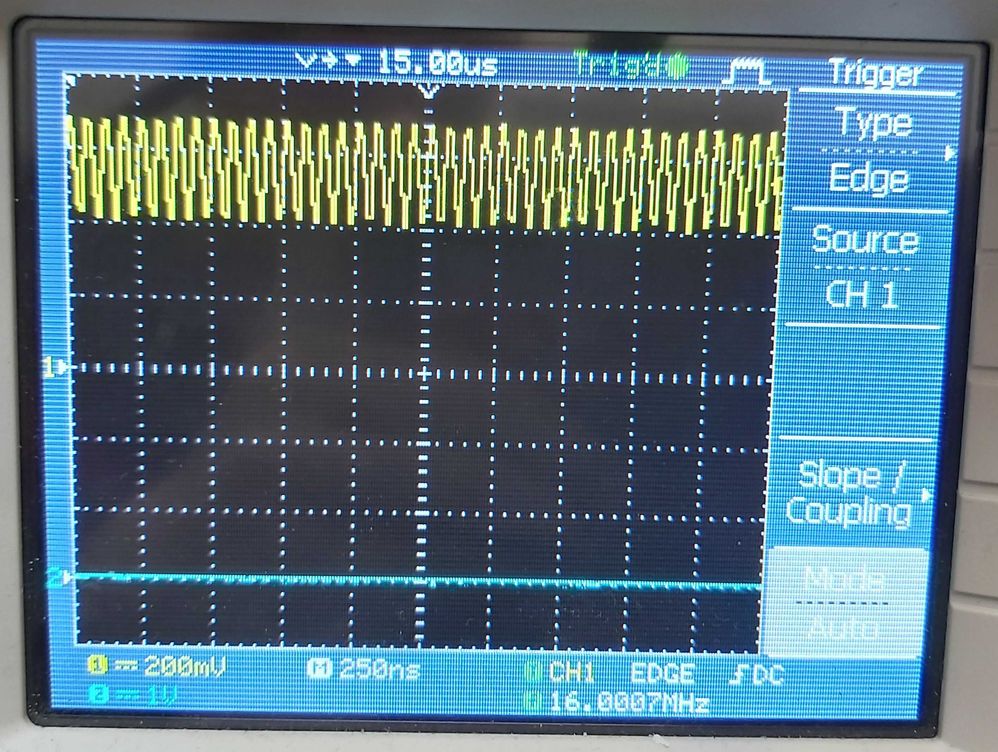

The 1V8 and 1V2 are OK and the 16MHz clock is ticking at 16MHz correctly.

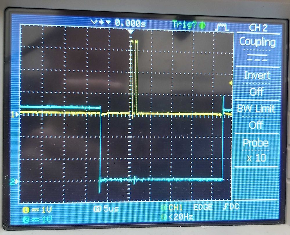

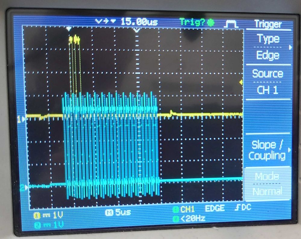

}I can see the trame {0x0a, 0x00, 0x00, 0x00, 0x00} on the oscilloscope on MOSI and there is nothing on MISO. Which indicate that the SPI is not ready, then the function return a Timeout.
Figure 1. SPI_MOSI and SPI_CLK during (BSP_SPI4_SendRecv(header_master, header_slave, HEADER_SIZE);)
Figure 2. SPI_MOSI and SPI_CS during (BSP_SPI4_SendRecv(header_master, header_slave, HEADER_SIZE);)
Figure 3. XTAL2 after SPI_RESET goes HIGH.

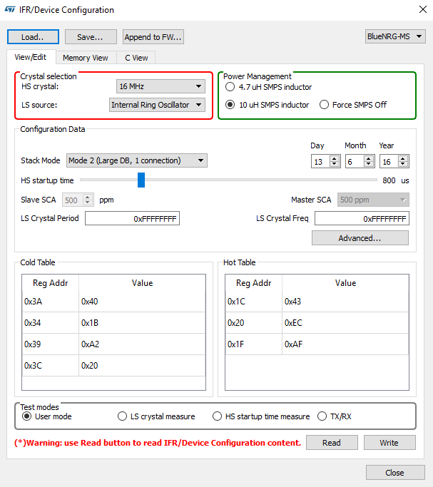

Please check STSW-BNRGUI package
2021-02-18 12:56 AM
Thank you for the reply.
I have checked yesterday this IFR configuration. I found this file "ifr_3v1_003_mode02-32MHz-RO32K_SMPS_OFF.dat" under the folder : "BlueNRG DK 2.0.2\Firmware\BlueNRG-MS_stack\SMPS_OFF" which correspond to my design.
I've copied the last 192Bytes which correspond to the IFR section of the µC and pasted them in bluenrg_IFR.c like this:
#define BLUENRG_CONFIG BLUENRG_CUSTOM_CONFIG
#elif BLUENRG_CONFIG == BLUENRG_CUSTOM_CONFIG

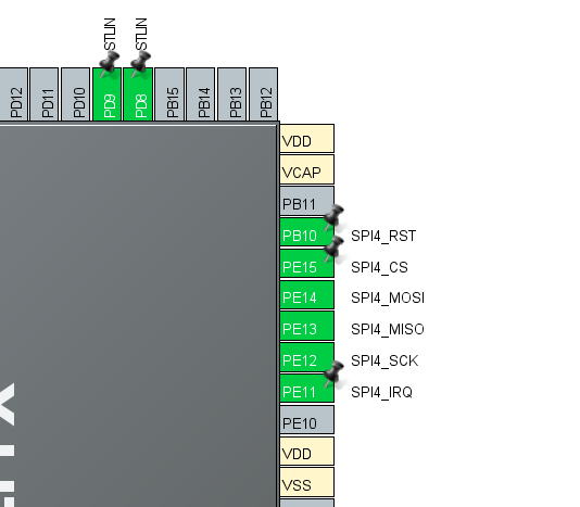

Maybe it has something to do with the pins I use: If you have any guesses =)

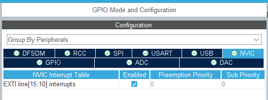

2021-02-18 8:18 PM
When Default_Handler is called, it means the processor receives an interrupt but doesn't know to handle that interrupt. This is mostly because the interrupt (ISR etc) is not configured correctly.
It seems that the configuration of EXTI line is missing from your implementation? Check HAL_EXTI_SetConfigLine()?
2021-02-19 2:53 AM
Thank you for the answer.
I Activated the EXTI lines Interrupts and verified that the interrupt was correctly configured. It seems to work.
