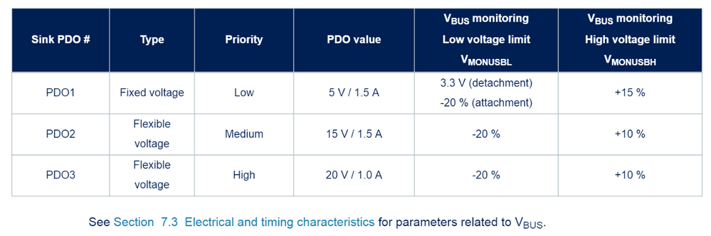

As per the table in the datasheet PDO3 has the highest priority?
2021-01-29 4:19 AM
Sorry that my wording was not precise.
I meant to say that when number of PDOs are set to 2, PDO2 (and PDO1) will be used instead of PDO3 (and PDO1).
As for priority when all PDOs are valid, it would be PDO3 > PDO2 > PDO1.
