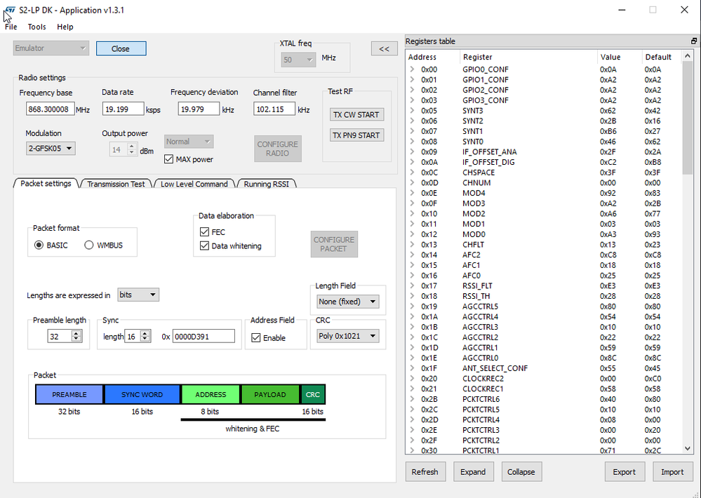

I generated a register configurations according to information provided by you, please doubly check.
Some of the settings are not clear:

2020-03-30 1:53 AM
Hi Winfred,
Thank you for your answer.
Here you are my answers:
1. The XTAL frequency is 50MHz;
2. The channel filter is 100kHz;
3. Data whitening and FEC are both enabled. In my code I disabled the CRC check to do some tests. Anyway the CRC should be on 16 bits, with Poly 0x8005.
Please note that to communicate with CC1101, I’m using the ST evaluation board and it gives me CRC error any time and I don’t know why.
P.S: About the CC1101 I know only this parameters setting:
1. charater recetion 32;
2. package length: 52
3. destination address: 1;
4. channel number: 7;
5. baudrate: 19.2 kbps;
6. Rx filter bandwidth: 100kHz;
7. Modulation: GFSK;
8. Frequency base: 868MHz;
9. Preamble 8 bytes (0xAA);
10. Sync 2 bytes (0xD391);
11. CRC (I think evaluate on 16 bits with poly 0x8005).
Please note that I configured my S2LPDK in the same way showen in your picture, but it didn't solve the problem. I changed only the preamble length and the CRC type (0x8005).
Do you think that S2LP and CC1101 are incompatible and unable to communicate with one another?
