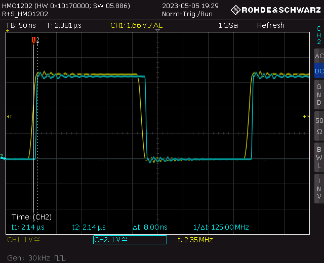

The LVDS itself works pretty well, as shown in the screenshot below: A signal delay of 8 ns from LVDS Driver IC input to LVDS Receiver Output is IMHO more than good enough for a reliable hardware layer, especially at that slow speed.
Screenshot. SPI Clock signal Master LVDS Driver Input (yellow), Slave LVDS Receiver Output (blue)

I am pretty sure it’s not a hardware issue. Even at 8 MHz SPI Clock, the delay created by the LVDS ICs (8 ns, or 16 ns from Slave to Master) are negligible, if the SPI shifts the data on the rising edge and samples the data on the falling edge, as the duration of one clock cycle is 125 ns.
