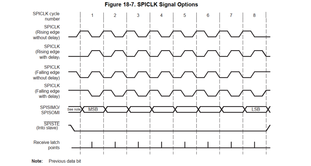

I am working on SPI communication between two boards, of two different companies.
TMS320F28397D of TI and STM32F429 of ST.
My question is about the SPI configuration in CubeMx, should I chose the Frame format TI?
2/When I chose The TI configuration CubeMx don't accept this frame? should I download any framework to let CubeMx accept this chose?
The issue is I am always receiving 255 side TI.
Thank you in advance,
S.Tarik,

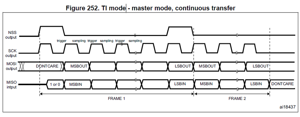

"TI mode" means there's a pulse on NSS prior to the MSB of each byte. This is rarely what you want, even with TI chips.

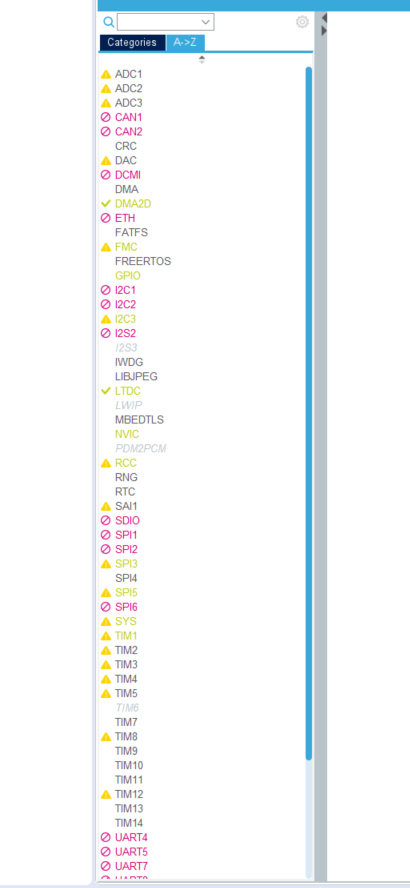

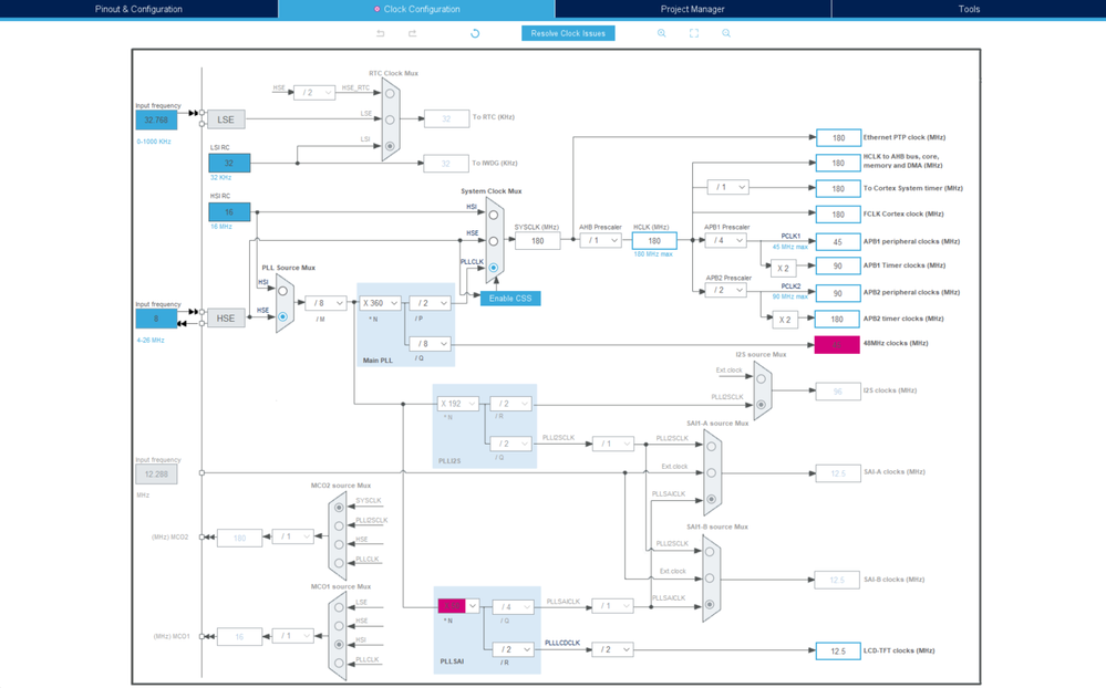

Could tell me please why i have this red in clock configuration and peripheral please.
One thing please, Why I have this warning around the spi3?
Thank you for help
