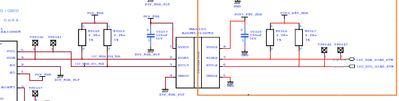

@Mnfz wrote:
an overview of my connections
You didn't previously mention an isolator. Part number?
Does it work without the isolator?

But this looks strange:
@Mnfz wrote:
(C = 100nV)5v|VDD1 VDD2|3v3 (C = 100nV)
INA228-SDA<---2.2KO--->+ ADUM1250SRZ +<---2.2KO---> I2C-SDA-stm32
INA228-SCL<---2.2KO----+ +<---2.2KO---I2C-SCL-stm32
|GND1 GND2|

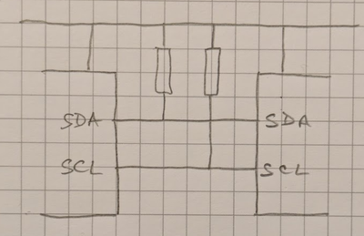

Are you saying you have the 2k2 resistors in series between the devices?
Pull-ups should go like this:

@Mnfz wrote:
it's  a better schema i think !
Better - we can see that the pullups are properly pullups - but too low resolution to read any of the text.
Again, have you tried this without the isolator?

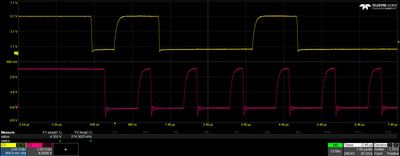

Mnfz
Associate II
This is a visualize simultaneously signals on clock and data lines , I notice a desynchronization between the data
and the clock, it seems as if its the source of my problem, data frames are not cached due to this  is that correct ?
As for signals shapes, i think there is no problem related to Pullups, what do you think?
Is that before or after the isolator?
Again, does it work without the isolator?
