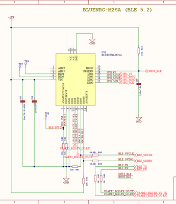

A BLE Project for developed on steval-mksbox1v1 which had SPBTLE-1s.
Since it became NRND we switched to BlueNRG-M2SA Module which has same footprint.
Using the BlueNRG-1_2 DK 3.2.3 I have tried to get build the project with following pin changes as per mksbox connections - in hw_config.h
#define SPI_CS_PIN GPIO_Pin_1
#define SPI_OUT_PIN GPIO_Pin_2
#define SPI_IN_PIN GPIO_Pin_3
#define SPI_CLCK_PIN GPIO_Pin_0
But to my despair the in the built project binaries flashed into the module, the IRQ pin never becomes high in this firmware and the HCI code does not progress as IRQ low. In short the module does not initialize.

Done the above changes. Results unchanged. No IRQ on BLE_INT Pin.
No more idea on my side.
May be could you confirm using DIO7 as IRQ as our default example, you can see IRQ rising up (you can add wire to modify your PCB)?

As you can see we are using DIO14
Yes I see.
My request is maybe to rebuild FW with DIO7 as IRQ and modify your PCB as a test.
DIO7 is the default IRQ used in our example.
This is to see if this is related to DIO14 and any specifc thing around it.
Laurent
