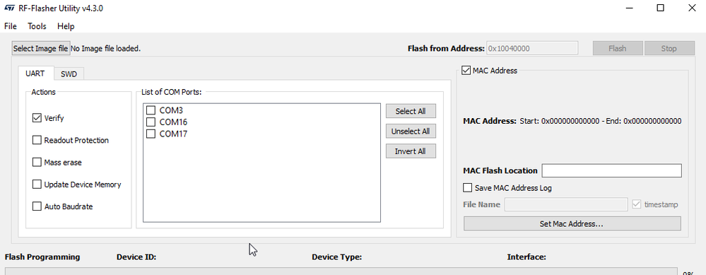

I would like to exploit BLUENRG-X-FLASHER UTILITY ability to program MAC Address to BLUENRG-2 from the ST-link command line interface in mass manufacturing. Is it possible to do my intention?

2023-07-24 7:21 PM
Hi Ilker B,
The function has been already available in RF-Flasher Utility.
at the top right corner in the GUI:

2023-07-24 10:53 PM
Hi @Winfred LU ,
I use this option exactly. But my problem is that; how to read this flash address from my host microcontroller ?
