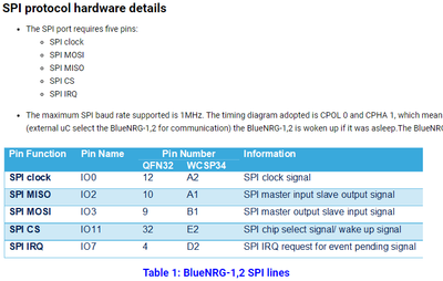

Please note DTM SPI FW for BlueNRg-M2 is already provided in BlueNRG-1_2 DK 3.2.3.
You will also find in this SDK documentation, the recommended mammping for SPI and IRQ (corresponding to this FW).
I then recommend this SPI mapping and the provided DTM SPI FW.

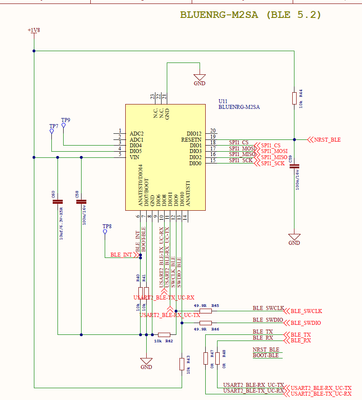

Hi Laurent,
If you check steval-mksbox1v1 sensortile board schematic, in that board the pins are not same as the firmware binary or source code provided in BlueNRG-1_2 DK 3.2.3.
Our board was made on that basis thus my pins are as following -
#define SPI_CS_PIN GPIO_Pin_1
#define SPI_OUT_PIN GPIO_Pin_2
#define SPI_IN_PIN GPIO_Pin_3
#define SPI_CLCK_PIN GPIO_Pin_0
#define GPIO_MODE_SPI Serial0_Mode
#define SPI_IRQ_PIN GPIO_Pin_14
Regards

Ok but the point is that if you refer BlueNRG-2 datsheet (BlueNRg-2 is the SoC included inside BlueNRG-M2 module), you will see SPI CS can be set using aither DIO1 or DIO11 (see bluenrg-2 datsheet table 130)
But DIO1 is not a wake up capble IO (see BlueNRG datasheet chapter 3.4.1.3)
So if you use a DTM SPI FW inside BlueNRG-2 that is having sleep mode enabled, DIO1 will not be able to wake up BlueNRG-2/BlueNRg-M2
So either you use DIO11 pin as CS pin and you can use a DTM SPI FW with sleep mode, either you need to disable sleep mode in DTM SPI FW if you want to use DIO1.

2024-05-22 3:12 AM
I very well get your this point. Due to this concern what I did is I keep DIO1 as the chip select but I also operate DIO11 from another GPIO(USAR2_BLE_RX_UC_TX) along with the CS function to wakeup and sleep the BlueNRG Chip.
The question though is not about sleep majorly but basic SPI Communication with the BLE IC.
I have noticed the BLE SPI INT Pin does not go high and due to which other codes SPI Write gets stuck waiting for it.
Regards
