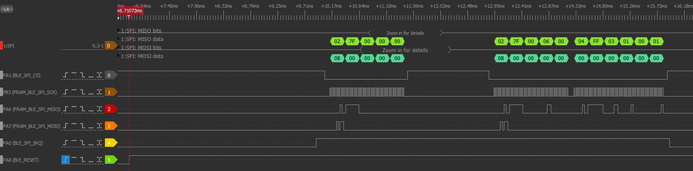

Hello Antonio,
I have bought the
X-NUCLEO-IDB05A1.
I get this logic diagram after callBlueNRG_Stack_Initialization();! It's OK.
I get similar result on my own PCB.

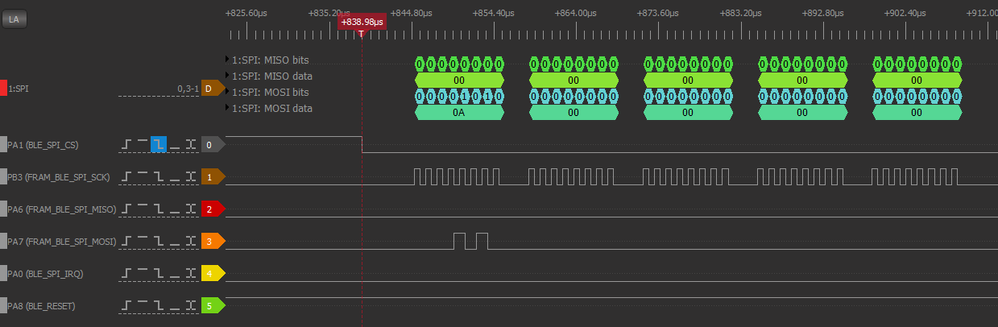

After I try to get rand with the hci_le_rand function.
The SPI interface of SPBTLE-RF is not ready.
How can this problem be solved?
