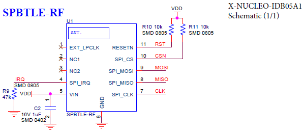

2018-03-28 8:17 AM
Do you have a pull-down resistor on the IRQ pin of your custom PCB?
In the
board, based on the same SPBTLE-RF module, there is a 47k resistor, as you can see below.If you can't make it work, I suggest to try running some of the examples provided with the
package along with a hardware configuration that is known to work, such as NUCLEO-L476RG and X-NUCLEO-IDB05A1.Best regards,
Antonio

2018-03-29 3:53 AM
Hi Aleksey,
the inner pull-down could be fine, but I've never tested this configuration. In all the boards that I am using, there is an external resistor.
If you can find a
NUCLEO-L476RG and an X-NUCLEO-IDB05A1 board, you will have a working reference that should make it easier for you to check what is going on in your custom board.
