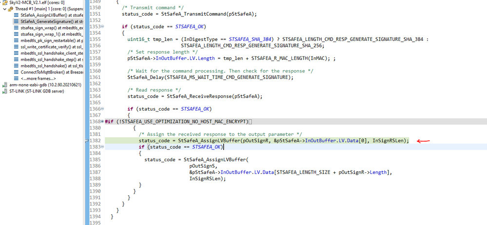

Hi @Benjamin BARATTE
Thank you for the immediate response.
I tried your suggested method and didn't generate key pair and CSR for slot1.
I hardcoded certificate in the flash.
Passed STSAFE_GetMbedPK_ECDSAInfo_1 to pk.pk_info.
The handshake went ahead and gave error when StSafeA_GenerateSignature was called from stsafe_sign_wrap_1().
I have attached the debug session image for the reference.
The highlighted line 1382 returns "STSAFEA_INVALID_RESP_LENGTH", upon more inspection into that function, I see the pDestLVBuffer->Length = 48 but ExpectedLen = 0;
Please suggest.
Thank You.
@Benjamin BARATTE
Edit: I figured out g_key_1_size was initialized to 0 which should have been 48 as I generated SECP384 key. Now the handshake worked.
Going to try out saving the certificate into the STSAFE flash and will update you soon.
Thank You.:folded_hands:
