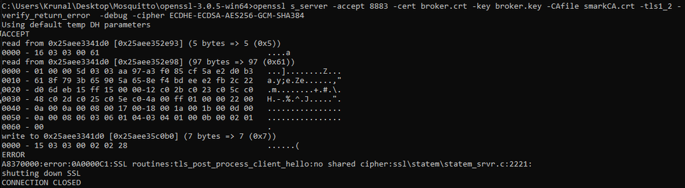

Next, I tried using your provided command for openSSL, this time also without client authentication, but i am still getting that "no shred ciphers"
Here I have attached errors debug for device and openssl.

I see that the server use AES256 and SHA384 while the client does not propose such ciphersuite.
Did you activate the MBEDTLS_SHA384_C and MBEDTLS_SHA512_C ?
I see in the MbedTLS definition that the AES256 is only linked to the SHA384.
Therefore if you activate the SHA384 (and SHA512) you should provide more ciphersuite and be able to match server preferences.
Best Regards,
Benjamin

You were right, I had missed to enable MBEDTLS_SHA384_C.
