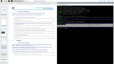

I am using a pcb4188_vd66g1 camera module with a Raspberry Pi 5.
The system has been freshly set up with Raspberry Pi OS 64-bit, and I followed the official setup guide step by step.
After completing the setup:
I have also read through several forum threads on this topic and have already tried many of the suggested troubleshooting steps, but the issue persists.
Could you please help me identify what might be causing the problem and how to resolve it?
Additionally, I noticed the following behavior:
Also there was a fragment warning but I don't think it is concerning (but I'll just mention it)
