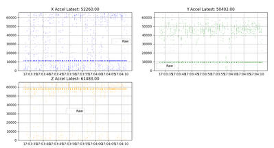

This has resulted in the following data output: (this is a small snapshot)
I will also post part of the .csv with raw data
What I am wondering is:
1. How do I interpret the data? What are the units here?
2. Are the artifacts I am seeing here just noise or am I processing the data wrong? To me it looks like the solid line is the actual data (the sensor was not moving as I did this) but I am not 100% sure of this.
Thank you all in advance for the help!
JC

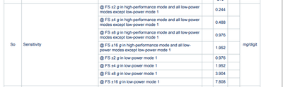

You are getting data in LSB, to convert them to mg you need to multiply the output by the correct sensitivity accordingly to the FS:
Yes, the artifacts could be noise, but I suggest you to check your code with our official examples on Github.

Thank you so much!!! I will look into the examples to get a better idea of implementation!
