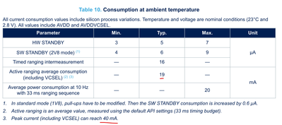

VL53L0CX average power consumption is 19mA, and the peak current is 40mA, so in theory if your power regulator can provide 200mA, that should be enough.
I checked power regulator XC6206P332MR is LDO, and input volage is 3V3, target output voltage is 3V3, this is strange set up, maybe you can try to bypass the regulator or connect a 5V as input for XC6206P332MR.
