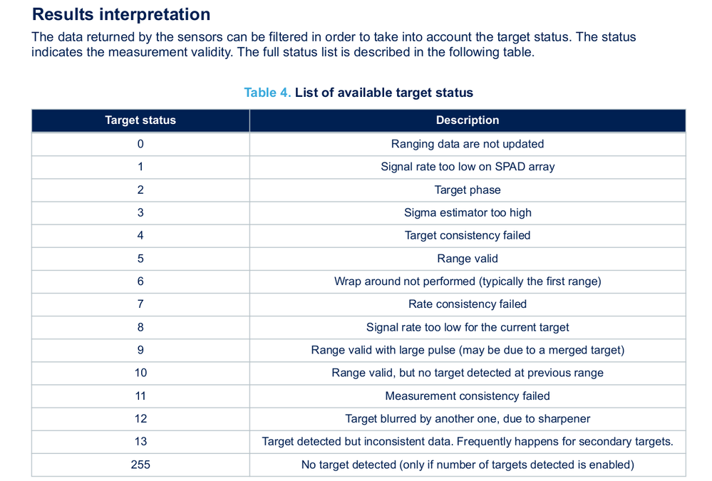

2025-04-23 9:24 AM
Hallo @ahsrabrifat ,
Thanks for your help but i am not sure this would help me. Then in one Documentation you can be read this :

As John says for now just look at zones which have status == 5.
With regards the range data you are printing out.... in the platform.h file do you have the following line active or commented out?
#define VL53LMZ_USE_RAW_FORMAT
If this is present the driver returns the raw range value which includes 2 fractional bits ...which means the raw value must be divided by 4 to get the actual range in mm.
Please look at the code within vl53lmz_get_ranging_data() which is conditional on the VL53LMZ_USE_RAW_FORMAT define. Depending on if this is defined or not it either does, or does not, convert from "raw" to real values.
2025-04-23 10:28 AM
The above post is incorrect .... target_status == 0 actually means the the data IS NOT VALID and should be ignored.

@RogerM Thanks , I think you just saved my life :). I was honestly about to give up.
