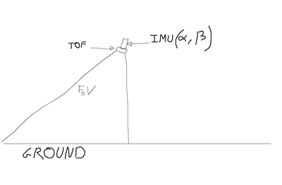

Sorry if my original question was not clear enough. Let me clarify what I am trying to do.
First of all, I perfectly understand what you explained in 1.1 and 3.1.
However, in my application I do not want to mechanically force the sensor to be perfectly parallel to the ground. The sensor is mounted in a system that can be slightly tilted, and I know that tilt from an IMU. More precisely, I know the roll (alpha) and pitch (beta) of the VL53L8CX with respect to the ground.
So my actual question is the following:
If the VL53L8CX is slightly rolled and pitched relative to a flat ground plane, and I know α\alphaα and β\betaβ, how can I use those angles to correct the 16 zone measurements so that I recover the perpendicular distance from the sensor to the ground plane?
In other words, I am not trying to physically realign the sensor. I am trying to compensate for its known orientation in software.
A small sketch of the setup is attached below:
a VL53L8CX
an IMU rigidly mounted in the same system
known pitch and roll relative to the ground
ground assumed to be approximately planar
How can I use my pitch and roll to correct these distance so after the calculations I have all 16 values roughly equal ?
Thomas

Hi
As you may already got the answer from John, we have the radial-to-perpendicular inside the low-level firmware. so the radial distance was converted to the perpendicular distance, if you let the sensor perfectly parallel to the ground, then you will get all the zone distance roughly equal to the perpendicular distance.
you can try to disable the R2P with below command, then you can get the radial distance of each zone.
Once you disable the R2P, each zone will report the radial distance, normally the shortest distance zone is the one light axis perpendicular to the ground.
Br
