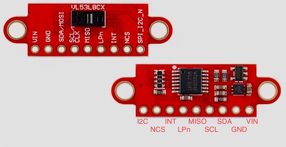

Associate II
Hi!
I looked into this forum topic more carefully, and it turns out my module uses the wrong level shifter.
This is a Chinese VL53L8CX breakout, and it appears to be populated with an unsuitable translator chip for this application. So the problem is most likely not in my firmware, but in the hardware design of the module itself.
That explains why I could get partial communication but never stable full initialization.
Thanks to everyone who pointed me in that direction.Sdbd910448b764b658941e534ecd66a26S.jpg_960x960q75.jpg_.jpeg

Hi!
Bin
Hi
Glad to hear you have found the root cause. Congratulations~
