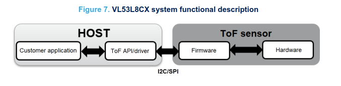

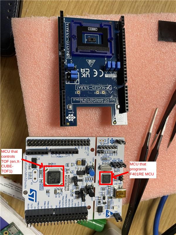

We have the two boards as mentioned below.
The Code generated in Cube MX is for the F401RETX(which configures the MCU inside VL53L8CX)
In the above diagram , the host is the F401RETX . Please confirm , if our understanding is correct.

Yes, your understanding is correct.
2025-04-24 1:46 AM
