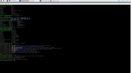

endifIs this a mistake? It looks like the vd56g3 driver. You can confirm by downloading the driver from the link. As a result when i complete all the steps and launch rpicam-hello i get this:
rpicam-hello
[0:30:33.792539716] [3479] INFO Camera camera_manager.cpp:327 libcamera v0.0.0+5323-a9c0f393-dirty (2025-02-17T12:13:30UTC)
[0:30:33.800260593] [3482] INFO RPI pisp.cpp:720 libpisp version v1.1.0 e7974a156008 27-01-2025 (21:50:51)
[0:30:33.801208462] [3482] WARN CameraSensorProperties camera_sensor_properties.cpp:473 No static properties available for 'vd56g3'
[0:30:33.801220202] [3482] WARN CameraSensorProperties camera_sensor_properties.cpp:475 Please consider updating the camera sensor properties database
[0:30:33.810869132] [3482] ERROR IPAProxy ipa_proxy.cpp:154 Configuration file 'vd56g3.json' not found for IPA module 'rpi/pisp'
[0:30:33.811002317] [3482] WARN RPiController controller.cpp:91 Failed to open tuning file ''
[0:30:33.811015076] [3482] ERROR IPARPI ipa_base.cpp:152 Failed to load tuning data file
[0:30:33.811028688] [3482] ERROR RPI pipeline_base.cpp:814 Failed to load a suitable IPA library
[0:30:33.811040428] [3482] ERROR RPI pisp.cpp:947 Failed to register camera vd56g3 10-0010: -22
Made X/EGL preview window
ERROR: *** no cameras available ***Is the driver for the vd66gy anywhere else to download?

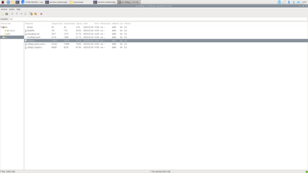

error msgs and data of the en.vd66gy_1.0.3 file which contains the vd66gy driver.
