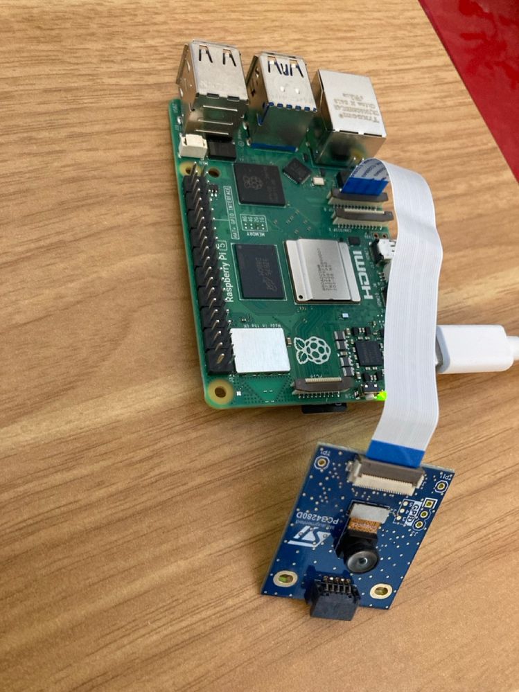

[ 5.357883] rp1-cfe 1f00128000.csi: found subdevice /axi/pcie@1000120000/rp1/i2c@80000/vd55g0@10Here is a photo of the physical setup, I think I have matched what is written in the Guide:
I know that the camera sensor and P-board are working (have already used it on a STM32N6-DK board), so this is very likely a software issue.

Thanks @CyrilTechPro , I got it to work! There were two problems. First, the Guide recommends installing the driver with `sudo cp *.ko /lib/modules/$(uname -r)`. However, apparently my kernel version changed afterwards (maybe due to `apt update` - not sure here, could also be some auto-upgrade of the Raspi running in the background). Of course the result is that the driver simply was not there anymore... After I fixed that (by re-installing the driver), there was still an issue, this was solved by adding `,cam0` when configuring the device tree overlay, as you recommended.
Thanks again!

Hello Michael,
Your device tree seems not well apply, could you change de device tree to pcb4280 to match with board pcb number.
This should not solve the issue,
Can you add ,cam0 in config.txt like this "dtoverlay=youroverlay,cam0"
I will change the guide.
Cyril
