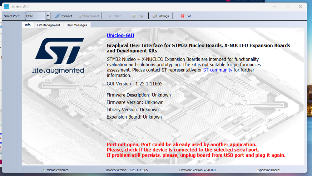

  • opened Unicleo GUI  (version 1.25.1.11665), then I see the new COM port (COM3) in the Select Port dropdown.
  • Click Connect, but the following error shows up in the "Info" tab :
Also, I get the following error in "User messages tab" : "Port: COM3 Open Failed".

I have just read that Unicleo-GUI doesn't support the STEVAL-STWINKT1B toolkit so I guess that explains the problem...
