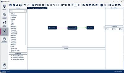

about the BLE communication, there is no example ready, you need to create the fw by the algobuilder.
click ALGOBUILDER
click FIRMWARE SETTINGS
Select the toolchain/IDE used
select TARGET SensorTile.box Pro BLE
You need to create in algobuilder a design with SensorHUB connected with the block needed (MotionFX 9x/quaternion example), then connect the display/fusion (or what you need)
click to INITIALIZE PROJ, GENERATE CODE, BUILD
then PROGRAM TARGET (the board must be in DFU).
Now restart the board
you need to do bluetooth pairing between the board and pc.
in windows add a new bluetooth device (remember to set the Bleutooth device discovery to ADVANCED).
You should see algob device in new device, do the pairing with 123456 as the code.
Now in memsstudio, click CONNECT, Connection Type "bluetooth" and you can see the board.
This way you should be connected via BLE to memsstudio.
You can edit the C code you created with your toolchain but you should not edit the bluetooth part.

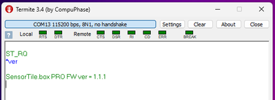

We need to check if the USB is correctly installed. Try this test for USB communication.
Once the board is connected to the pc via USB and turned on, look for the installed com, then with a terminal as TeraTerm, hyperterminal ( 115200bd 8N1, no handshake) try typing "*ver" and verify if the board responds with the FW version number:
Please, check also the led status of the board.

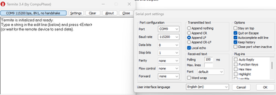

2025-03-17 1:12 PM

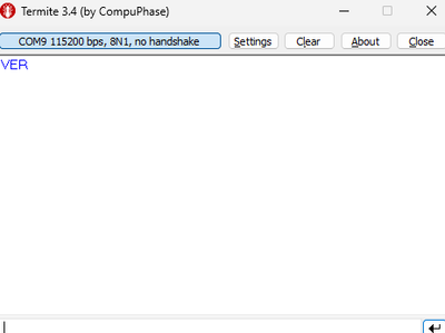

i plugged in device and turned on. I downloaded Termite 3.4 by Compuphase and selected correct COM9 11520 BPs 8n1, no handshake
typing VER yielded no result. sensor lights all turn on
Confirmed that the cable is data usbc

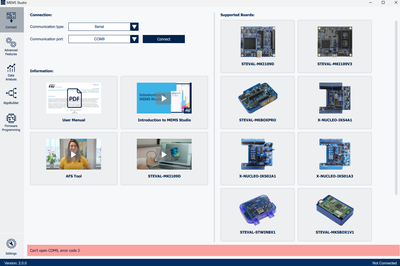

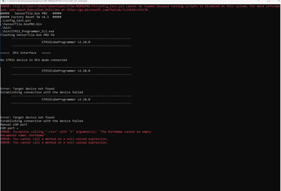

can I get specific instructions on how to install the firmware? Device manager detects a COM9. I downloaded STM32CubeProgrammer from the sensor tile box pro firmware and the EXE is giving me this error

Hi @khonsaiho ,

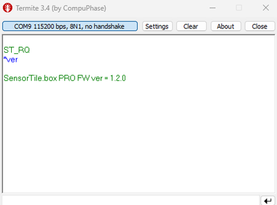

the correct command to read the version is
*ver
by this command you should read the firmware version.

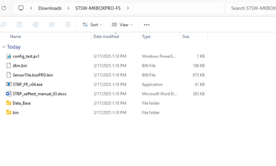

The link of binary file to flash via cube programmer is
https://github.com/STMicroelectronics/appconfig/blob/release/bluestsdkv2/bin/steval-mkboxpro/STSW-MKBOXPRO_1_2_1.bin
if there are problems we recommend the factory reset procedure following this link
https://www.st.com/en/embedded-software/stsw-mkboxpro-fs.html
2025-03-31 10:48 AM
it's reading as SensorTile.box PRO FW ver = 1.2.0
getting error that reads COM9, error code 2
