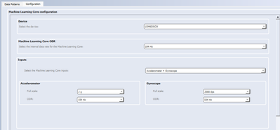

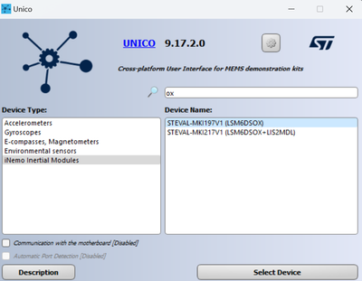

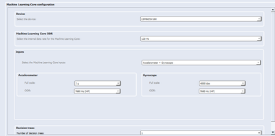

I select this configuration

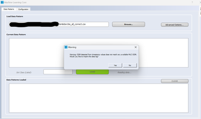

Following the step this error occur to me but clicking yes it goes on

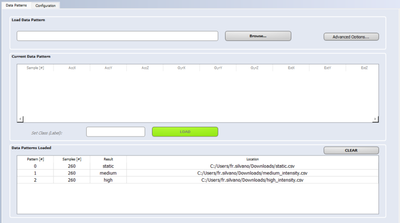

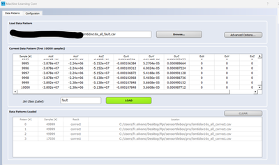

I upload both files with the correct label and fault label and here comes the first doubt,

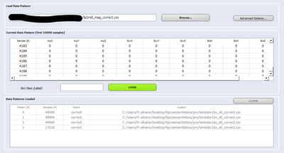

If i upload the magnetometer file it gives me no data even if the file cvs is full, how can i upload the data from magnetometer?

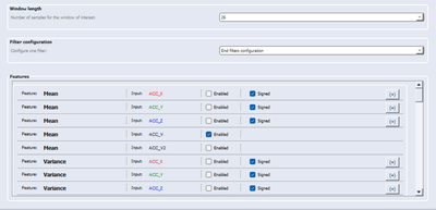

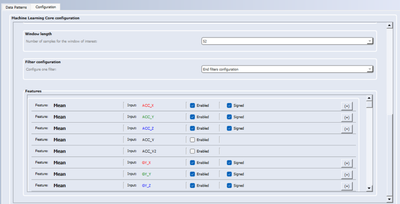

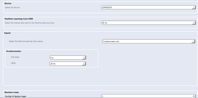

Moving forward, I use this configuration:
with one decision tree, windows lenght of 52, no filter and the mean of acceletometer and gyroscope

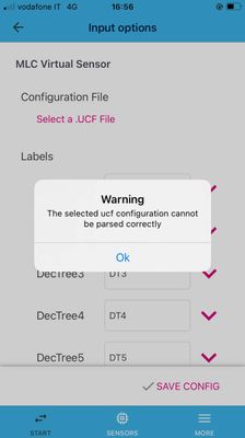

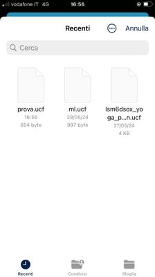

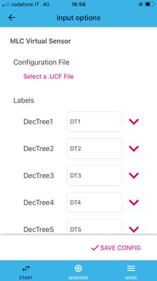

I then tried to upload the UCF file via the app (both Android and iPhone), but I get this error:
Someone can please help me? what did i do wrong?

For the magnetometer issue, you want to use the MLC feature with the sensor hub interface to include the magnetometer data right? In that case the log data should not be two different csv files but a single csv file with all 3 sensors. Somehthing like this for example:
time[us],acc_x[mg],acc_y[mg],acc_z[mg],gyro_x[mdps],gyro_y[mdps],gyro_z[mdps],mag_x[mG],mag_y[mG],mag_z[mG]
4344450,4,-34,998,-280,560,-280,-654,469,-117
4347473,4,-33,997,-70,210,-140,-654,469,-117
Then, in Unico, when selecting the MLC inputs make sure to select also the external sensor option and include the desired features.

I'm using the SensorTile Box Pro with Datalog2 inside, and I used the basic configuration to collect data:
  • Magnetometer ODR 100 FS 50
  • Accelerometer ODR 7680 FS 16
  • Gyroscope ODR 7680 FS 4000

For instance, the UCF was done for the LSM6DSOX, and using the app connected with the SensorTileBOX.Pro you need the UCF for the LSM6DSV16X. By generating the correct UCF and connecting the Pro board, the application error should be fixed.

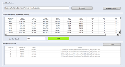

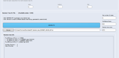

I just realized that the tool only accepted CSV files with accelerometer data followed by gyroscope data. So, I have recreated the CSV files so that they can be read correctly by the tool.

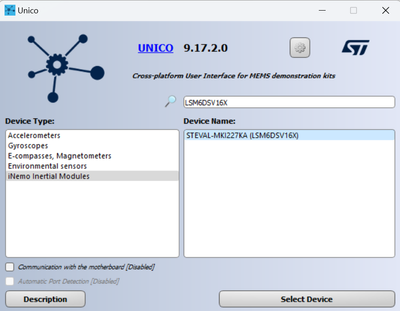

So now i select the iNemo inertial module (is that correct?) with device LSM6DSV16X
i then select the two different csv one for fault and the other for correct
with this configuration

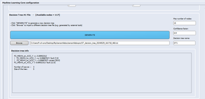

this decision tree pop up
and generates this ml.ucf

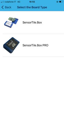

But still i have the same problem when i try to upload it in a new folw throw the app STBLE classic into the sensortile "The selected ucf configuration cannot be parsed correctly"
Federica Bossi
Hi @Frabbit ,
First of all to clarify:
  • The SensorTile.BOX has the LSM6DSOX sensor inside and is used mainly with the ST BLE Sensor Classic App.
  • The SensorTile.BOX Pro has the LSM6DSV16X sensor inside and is used mainly with the ST BLE Sensor App.
  • For each board, generate the UCF file for the corresponding sensor.
Having on your phone the UCF file generated for the sensor LSM6DSV16X, connect to you SensorTile.BOX Pro board using the ST BLE Sensor App. Open the Flow option:
Expert view >> New App >> Select Input Source >> MLC Virtual Sensor >> Choose Output >> Stream to Bluetooth. Click on the gear next to the MLC Virtual Sensor >> add .UCF FILE.
In this way you should be able to load the app.
In addition, you are using the wrong UCF file for the SensorTile.BOX since it should be the one generated for the LSM6DSOX.

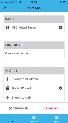

the ucf file was generated, i send it to my phone in the STBLESensor Classic app then create app>>SensorTile.Box>>Expert view>>New APP>>Select input>>MLC Virtual Sensor
then in settings>>Select a .UCF file, i select the one generated before and the same warning pop up... what can i do now?
