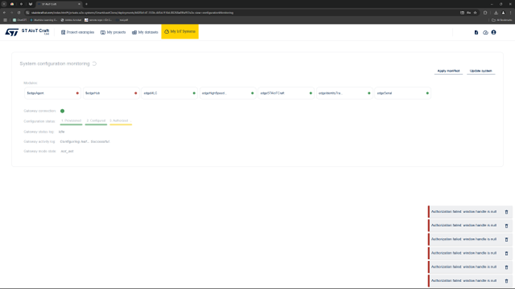

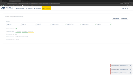

This is a screenshot of the issue with the Smart Asset Tracking sample:
I tried clicking on "Apply Manifest" but it didn't change the results:

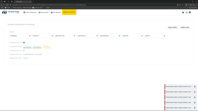

Just to be sure, I tried the Human Activity Recognition sample, with the same result:

2024-11-13 8:55 AM - edited 2024-11-13 8:56 AM

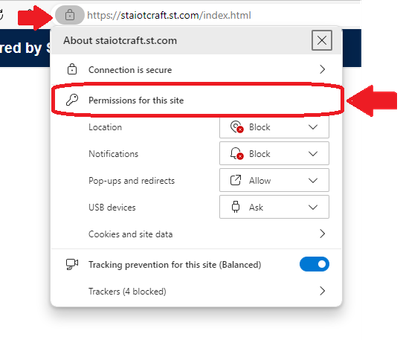

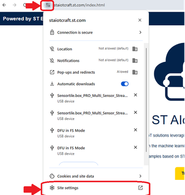

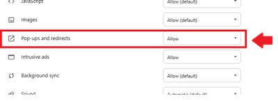

Hi Claudio,
it seems your browser is preventing ST AIoT Craft web app opening a browser tab automatically. Please double check your browser settings: Pop-ups and redirects option must be set to Allow.
To resolve, keeping ST AIoT Craft web app opened, please, follow below steps:
Hope it might help. Don't hesitate to ask if the issue persists.

2024-11-13 8:47 AM
Hey there Claudio,
I believe the application requests permission to open a pop-up window at that point, did you grant it? There should be an icon in the address bar just to the left of the bookmark star.
By the way, the screenshots are barely readable, if your problem isn't solved would you mind posting somewhat larger ones?
Hi Claudio,
Regards,
Davide

2024-11-13 9:07 AM - edited 2024-11-13 9:08 AM
Hi, thanks for the fast reply and sorry for the low quality images!
Sure, that solved part of the issue (my bad, but also: I wasn't seeing any pop-up asking to allow redirects)

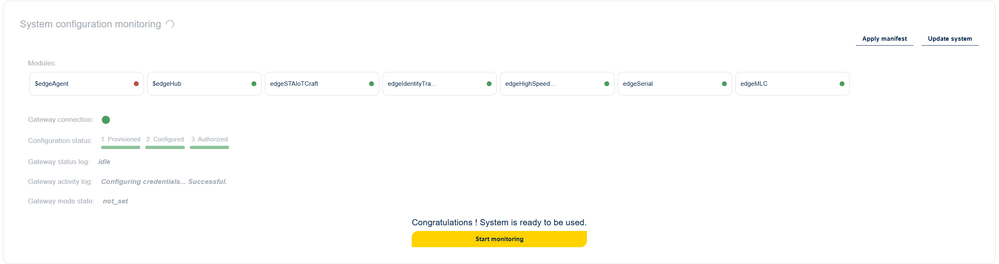

Now, this is where I get after authorizing:
Is "edgeAgent" being red an issue?
Also, unless I go to "Monitor" and click on "Start Inferencing" the leaf is shown as "Disconnected".
Last week I had an issue where the "monitor" graph wasn't updating properly.
Anyway, I was on a different browser where redirect are active by default and on an older version of the gateway OS (20241030_1_2_0_rc1).
Also: it was telling I was able to start monitoring even though "gateway activity log" advertised an issue.
By the way, everything seems to work now with the Human Activity Sample, I will try the other sample tomorrow and eventually let you know.
Hope image quality is better because other than reducing the screenshot size and selecting image-size-large I don't know what I can do :)
2024-11-14 4:04 AM
Hi Claudio, sorry for the late response.
Nope, it is not an issue at all.
That's correct as well. Gateway connects the leaf device to the cloud once you configure the overall system in Inference mode.
Yep, perfect now :)
Davide
