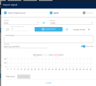

- Tried to import signals (regular ones) from USB using both COM port (COM 3) and COM4 (the virtual one) but when clicking "Start/STOP", data don't show up (see the following image) :

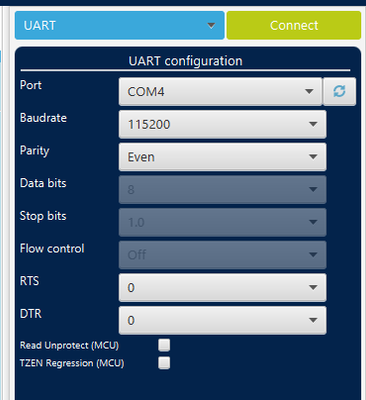

I have checked UART configuration and baud rate, parity, data bits, stop bits seem correct :

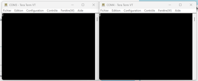

I also installed Tera Term to check if data is collected from COM3 and COM4 when clicking "Start/STOP"... it seems nothing is out.

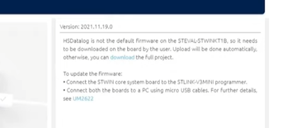

It is not clear which function pack I should use. In the youtube tutorial NanoEdge AI Studio V3 - Anomaly Detection demo, it seems they're using HSDatalog (see below) :
So I restarted from scratch. On STM32CubeProgrammer, I erased all sectors, then I loaded HSDatalog.bin (from FP-SNS-DATALOG1) into the board and STWIN-V3MINI. The bin file path is "STM32CubeFunctionPack_DATALOG1_V1.5.1\Projects\STM32L4R9ZI-STWIN\Applications\HSDatalog\Binary\HSDatalog.bin", is that the correct bin file ?

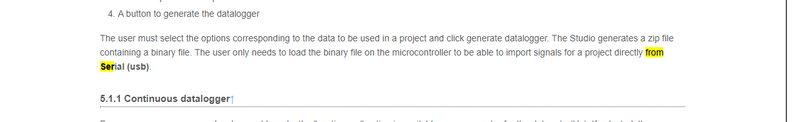

So I used the datalogger tool on Nanoedge AI (same configuration as my project, 3 axes (accelerations), output data rate 833Hz, full scale 16 g), I downloaded the .zip file and loaded the bin file (neai_datalog.bin) into the board (using STM32CubeProgrammer). That is what is said in the Nanoedge Ai's doc :

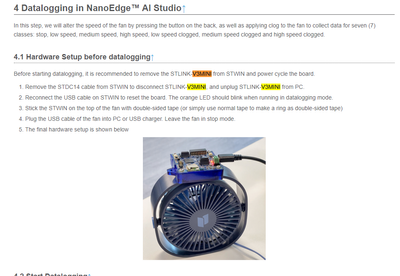

Finally, i followed these instructions (found at https://wiki.st.com/stm32mcu/wiki/AI:How_to_create_a_multi-state_vibrations_classifier_using_NanoEdge_AI_studio#Start_Datalogging:(
At this step, it seems the board is in datalogging mode as orange LED blinks. But in device manager serial COM port (COM3) no longer appears, there's just the virtual COM port (COM4):
So it comes as no suprise that live datalogging in NanoEdge AI is still not working. Can I know which steps I should follow ? I suppose I did not program the board correctly but idk what is missing.
