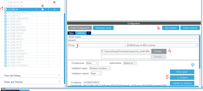

I am trying to integrate the a neural network machine learning model into the stm32h755 chip. I downloaded the stmCubeMx, installed X-Cube-Ai, selected the core, added the network using tflite file and then generated the code. I can't find the ai_model_data.c, ai_model_data.h, ai_model.h and some other important files. Could you please provide a detailed steps by step process to integrate the Neural Network in an ALREADY created/ EXISTING project?

If you have an already existing CubeMX project. Open your .ioc file with cubeMX and add X-Cube-AI as you would for a new project:
Then:
Then you generate the Code.

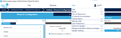

Because you activated X-Cube-AI, you can access the documentation by clicking help>X-Cube-AI Documentation:
In there, in the Embedded Inference Client API, you will find a getting started - Minimal application code.
I think that you can start by adding that to your main.c and see how it goes first.

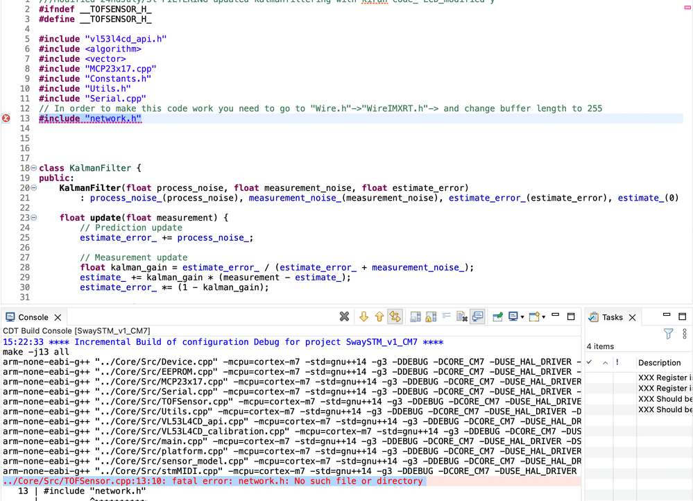

2024-10-02 10:31 PM

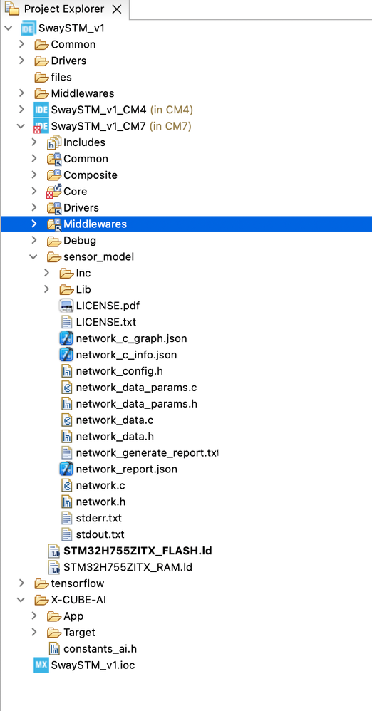

Thanks a lot Julian, I followed the steps and generated the C++ code from the developer cloud. But I am not able to integrate (#include ) it. I have attached the photos for reference. Could you please help me fix this?

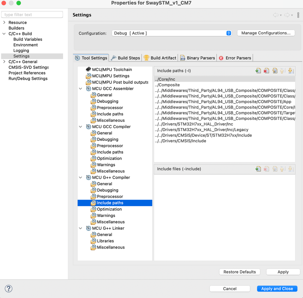

2024-10-02 10:33 PM
Consider this photo too

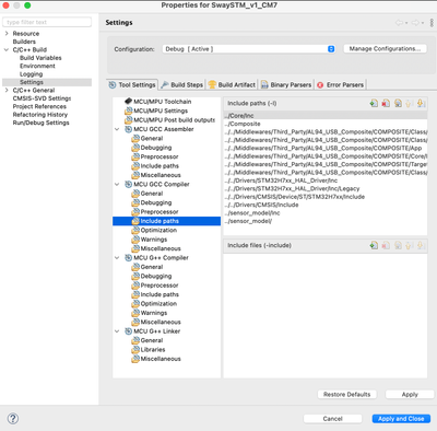

2024-10-03 12:31 AM
Hello @slodh ,
As you think, it seems to be an error in the paths.
You other paths start with "../..", maybe try to put something like "../../sensor_model/"
Have a good day,
Julian

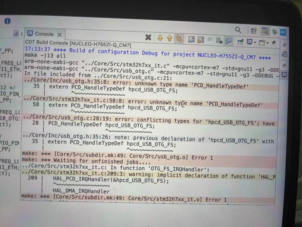

2024-10-09 8:33 PM
I tried integrating it with my the current code that I have. I am getting this error
2024-10-10 12:46 AM - edited 2024-10-10 12:48 AM
Hello @slodh ,
These kinds of errors are outside of my knowledge and scope of the EdgeAI threads. Please open a new thread in the ST Community in the right section like here for example: STM32CubeIDE (MCUs) - STMicroelectronics Community
Have a good day.
Julian
