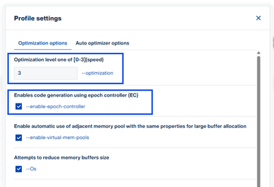

- Compilation flags for the ST Neural-ART Accelerator compiler (especially, `enable-epoch-controller`)

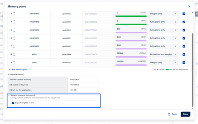

Potentially, try ticking this box to see if it accelerates your inference time, and check the settings here:
in Memory Pool (under menu "Target")
in Profile settings, if you work with profile "Default"
