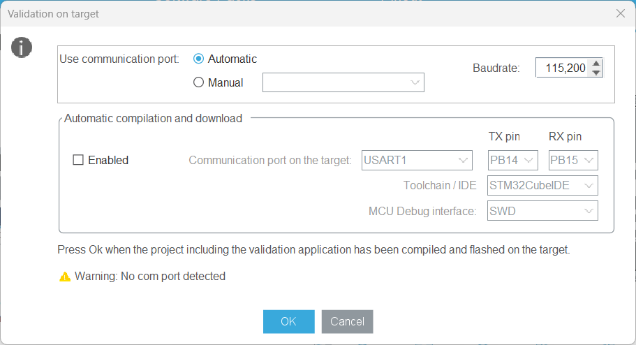

I'm a senior student majored in AI before and recently bought an STM32H743VIT6 to experiment with Edge AI. I haven't had any experience with embedded systems before. My ports seem to be missing, but CubeProgrammer successfully found my device through USB and allowed me to flash it.
How strange it is! My classmate mentioned that I need try an ST-Link, but I'm not entirely sure.It may be a very simple question but I don't know anything about Stm32H743VIT6 and how to start.

We support ST Boards that has an embedded stlink with virtual com port support connected to a USART on the target
You can find ST boards on the STM32H7 here: https://www.st.com/content/st_com/en/search.html#q=stm32h7-t=tools-page=1
You can always force the COM port to use if you have your own board that has this VCP support
